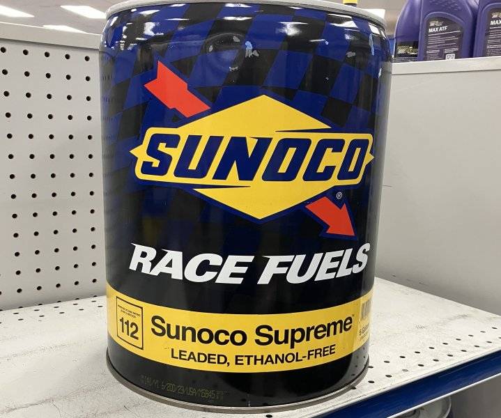

Yeah, I have the same problem with my relatively new motor, new fuel tank, fuel grade lines, etc. In the 80's and 90's I never lived in a house where I had the luxury to park the old car in the garage - it was parked on the street and we never noticed. I used to think my car's fuel smell 10 minutes after shutoff in the garage was the fuel tank pressure increase from being hot, but the carb bowl evaporation makes more sense.
I love the smell of gasoline. I REALLY love the smell of leaded gasoline.
