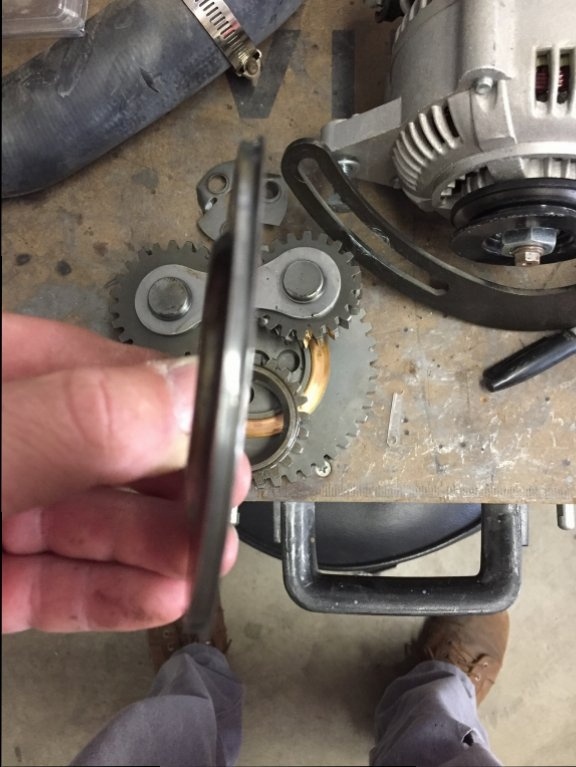

Got the gear drive out and something is not right here.

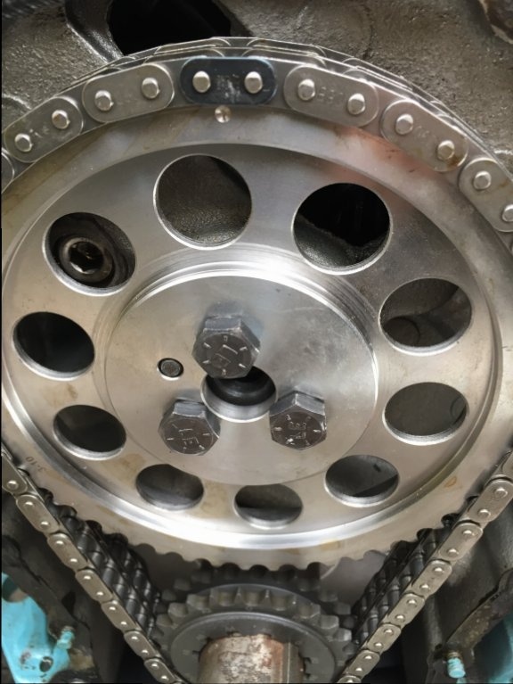

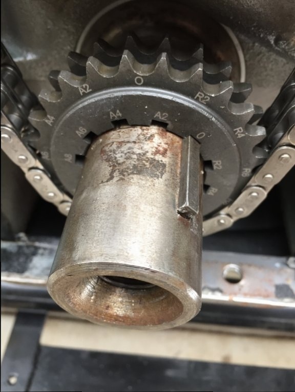

Before I touched anything, I got #1 to tdc, and the moved the crank to align with the timing tab (0). Tire it down and when I installed the timing chain/gears, this is what I got. Crank is at 0 with the dot at 12 and the the cam is showing 12 instead of 6.
I did not take the distributor out. So wtf is going on? Is this ready to fire off for #1?
Sweet! Just got others opinions and they concur.

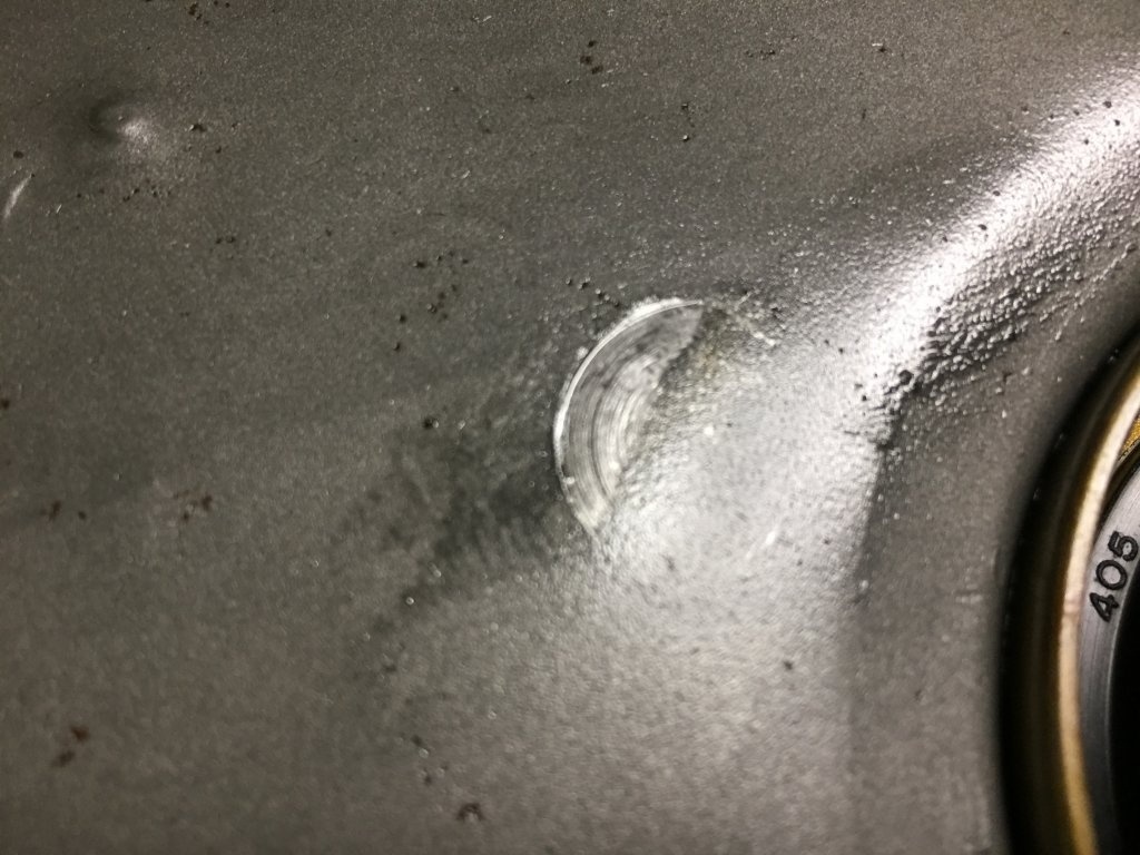

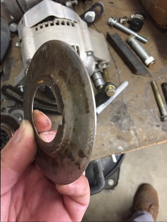

The carnage that was caused by the gear drive. The last pic is a spare I have.
