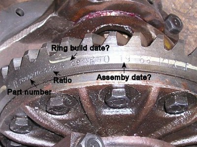

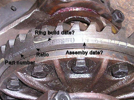

Here's a picture of what you are describing and the OP should look for.

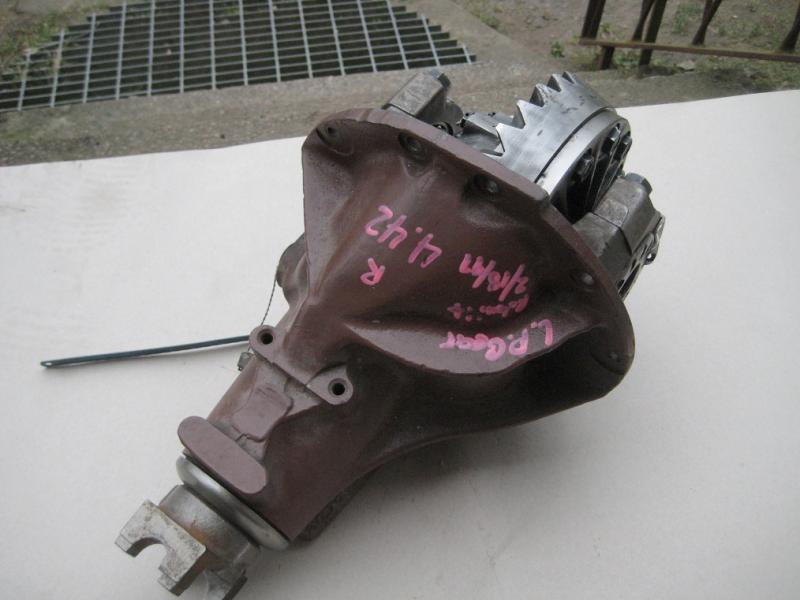

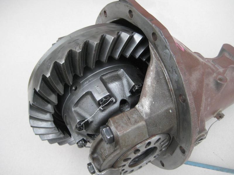

Ok! I have a 4.43 = 31/7 in a 742 house
