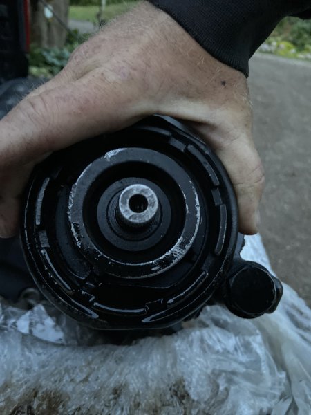

Every dam parts store I go to says they can’t get me a gearbox and the one that can we’re the lines hook up is way different. I have found a few on eBay but there around 7-900 dollars wth. Anyone have any suggestions? I live in northern Michigan and there is NO one that rebuilds these. I have seen a few videos on rebuilding them and I can probably handle the job but if I could find a reasonable priced one rebuilt I’d probably go that route. The one I have leaks were the steering shaft hooks up (second pic)Appreciate any suggestions Thanks in advance.

But you could also buy a seal kit from them for $50?
Thanks for the advice I’m gonna check them out. I did watch a few videos and did some reading in my repair manual I might just do the rebuild kit
