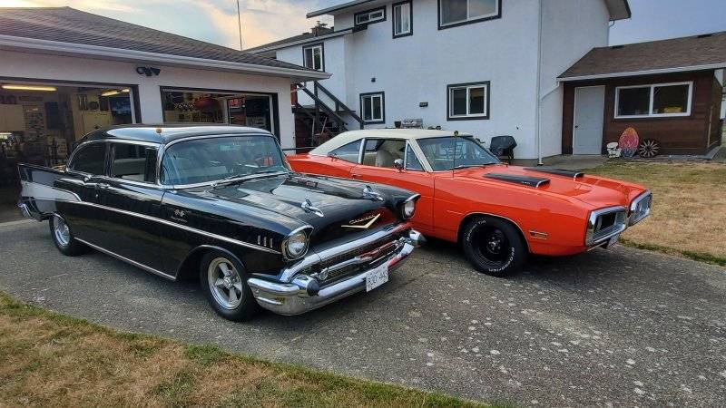

My 70 has a 440 833 8.75; I had 4.10's in it with 27" tires. It was great banging through the gears around town but on the highway it was buzzing up around 3300 rpm... no good in my books. We planned a group road trip so we swapped the 4.10's out for 3.23's and 28" tires. As expected the car was great on the highway (2500rpm+/- @ 65 mph) but it definitely paid the price in lost acceleration. This experiment makes it an easy decision; I'm keeping the 28" tires (275/60) putting the 4.10's back in it and I'm saving for the TKX 5 speed conversion.
My Belair (don't hate me lol) has a TKO 5 in it with 27" tires (255/60) and 3.5's, it's about a little under 2000 rpm at 65 mph. I use these calculators:
