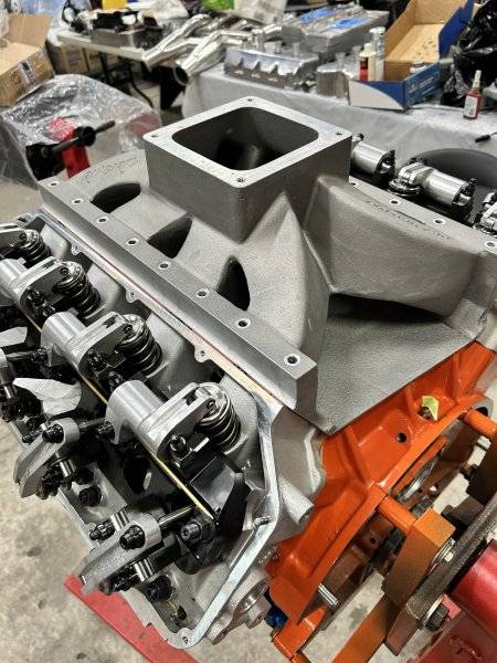

Stroker cost the same as a stock stoke engine. I’d do a 4.250 stroke combo with a Chevy rod to keep the internal pickup. Edelbrock heads will be your best bang for the buck. Hemi’s need some compression to run decent so 10.5 range or even a little higher with an aluminum block. If I were to gamble and run a flat tappet I’d probably go with one of Barton’s cam and tool steel lifters. Sorry, not a cheep date. If I didn’t go that route it would be a roller. Hemi’s should have solid cams but, given what you want I suppose “cringe” a hyd roller would work. there’s no cheep valve gear and I’m not a fan of any used 50 year old hemi parts. Stage V for valve gear and top with intake of your choice. YES, is going to make way more than 500hp but, it’ll cost the same at the end anyway so why not.. do it right and forget about it. Nothing worse than having your hemi getting out run by an engine that’s 1/4 the cost.
