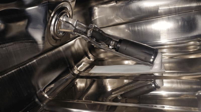

I have been working on a little project to utilize an intake pump and sender from a foxbody mustang in a stainless tank I recently purchased for my 69 Charger. The sender fits the opening of the tank like it was made for it, the locating tabs are even clocked to the same position and angle of separation. I combined the sender with a fuel strainer from a Probe/Escort (part# F241S). It fits remarkably well. I combined this with a fuel pressure regulator in the engine compartment to knock it down to 6.5 psi. Got it all installed and hooked up this weekend and everything seems to be working.

Have you tested it as to if it works with the factory gauge?
do you have the part numbers for the intank pump and sender? what fuel pressure regulator did you use
You can use any sender from an 86-93 Mustang. Fuel Pump/Sender Combo
-As for the pumps, you can get them in all sorts of sizes between 85 to 340 LPH. I would stay away from the big pumps until you are ready to do the EFI.
As for the regulator, I used THIS universal unit but can't recommend it. Stick with a holley or other name-brand bypass/return unit.
My charger had a 5/16 fuel line for a small block, so I added a new 3/8 line as a supply to the carb and left the old line in place as the return.
IMPORTANT CAVEAT: ...and potential deal breaker. You will have to attach your current fuel gauge sender to the new one or adapt a universal to retain the use of the stock gauge.
To answer your first question, yes, you can just disconnect the stock pump and let it hang in the breeze or you could remove it and install a block off plate to cover the hole. https://www.summitracing.com/parts/...MIsZ_A3OOG2wIVleDICh0miAvWEAQYASABEgJT8fD_BwE
