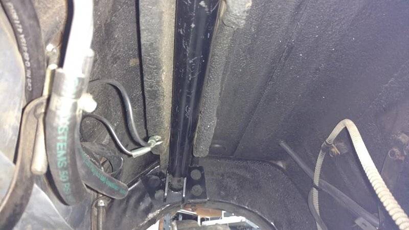

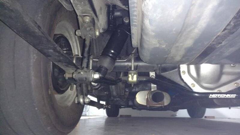

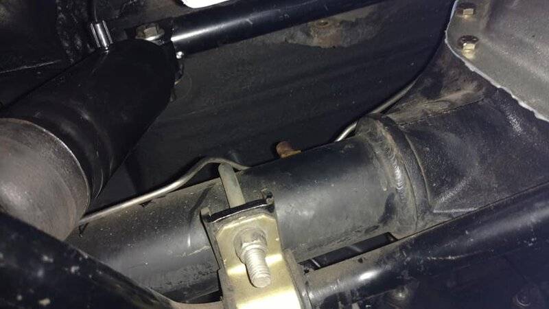

I also made a rear upper shock x member change, I bought a upper from RMS, that they use with the Street lynx 4 link set up, it is made to go in front of the Diff, I ordered mine without the upper arm welded tabs, turn it around backwards & install it in between the factory x member & it stands the shocks up more vertical. I had to remove my tail pipes for clearance, will have to do some modifications to the pipes , but will run with dumps for now, it is surprisingly quiet without them

Thanks Budnicks, it is just the upper shock mount that I put behind the diff, still has split mono leafs & Caltracs, yes it is still Stack EFI. I had been staying away from here because of a member REALLY gets under my skin, but I decided to not let him control where I post & hang out, its good to see you still here Bud !!!! :)

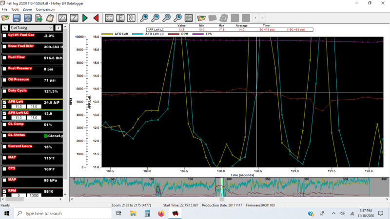

Well ,, went to the track on Friday the 13th , track rental $200 bucks & was only able to do one run,,, not bad about 20 cars, no road closures or detours this time so it was only 126 mile round trip, weather was nice 1550 DA, want to just make an easy 1st pass with the new 4.10 gear, car leaves very nice & smooth, I get just past the 1/8 & it starts laying down & burpin & fartin, click it into Overdrive thinking I was floating the valves, that was not the case, me & my FUEL VOLUME problems LOL!!!! VERY glad I have a Data log system, lookin at the fuel cells the ECU was adding 80% + fuel & all I had to do was look at the log for the fuel pressure & THERE it was, went from 55 psi to 30 to 20 to 6 psi & soon as I lifted it went right back to 55 psi, I will do the same volume test that Dwayne had me do last time I had problems when it had a Carburetor, I REALLY think my Fuel filter cant keep up, I ordered a new large 460GPH EFI filter & will do a 55 psi volume test as it sits now & then with the new filter,, my pump is a in tank 450 LPH pump, good for over 1k hp, sorry it took awhile for me to post about this, but I was so fed up with everything, I drove home, parked in the garage closed the door & haven't looked at the car since,,,, GRRRRRRRRR
TURN it up & listen
all the spikes are going off the scale lean & rich
on the left 8 psi fuel pressure
