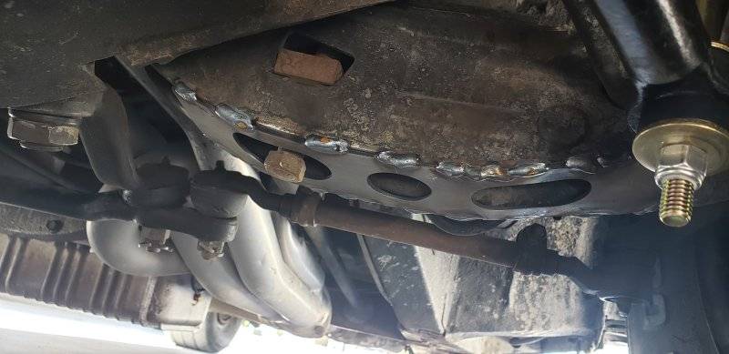

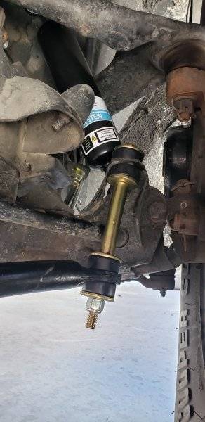

New Bilsteins, poly sway bar bushings, and boxed in LCAs. Took it for a spin and it is pretty smooth. Cruising at 70mph was nice.
New Bilsteins, poly sway bar bushings, and boxed in LCAs. Took it for a spin and it is pretty smooth. Cruising at 70mph was nice. View attachment 1328078View attachment 1328079
Going the wrong way for track duty. I drop the sway bar and put loose extension shocks on to get it off the line. Track is smooth, handiling should not be an issue. Hooking the car usually is..
It's a street car for the most part. I just want it to ride nice.
