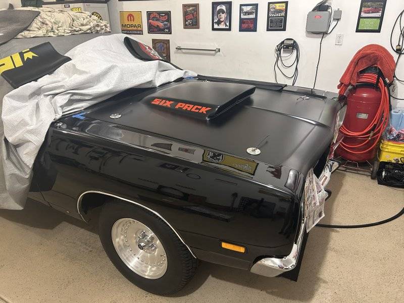

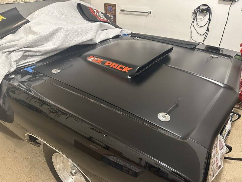

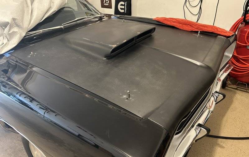

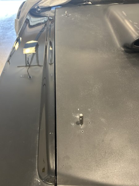

Beautiful Glasstek hood installed. Was way easier than I thought, especially after measuring 5 times and drilling once. Now for paint and final brackets install/tightening.
:thumbsup: I would like one for my 70 Bee
Yes, got the rear brackets and pins from Jim’s Mopar Parts in NH. Nice thick steel.

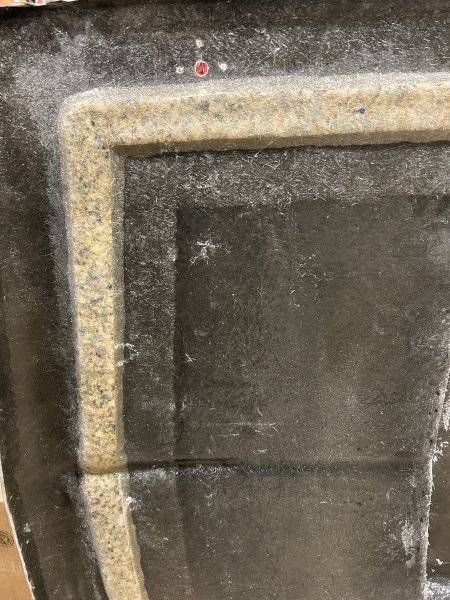

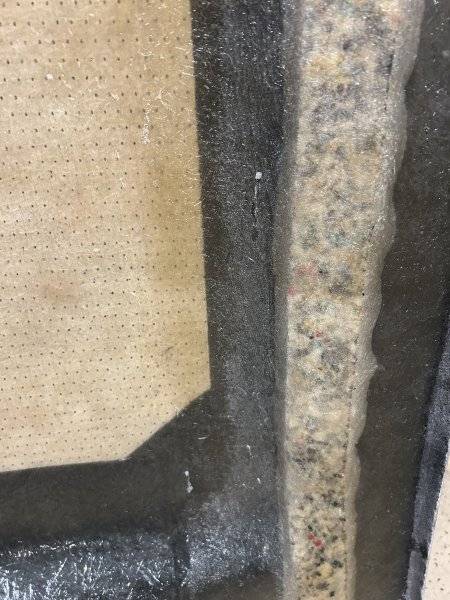

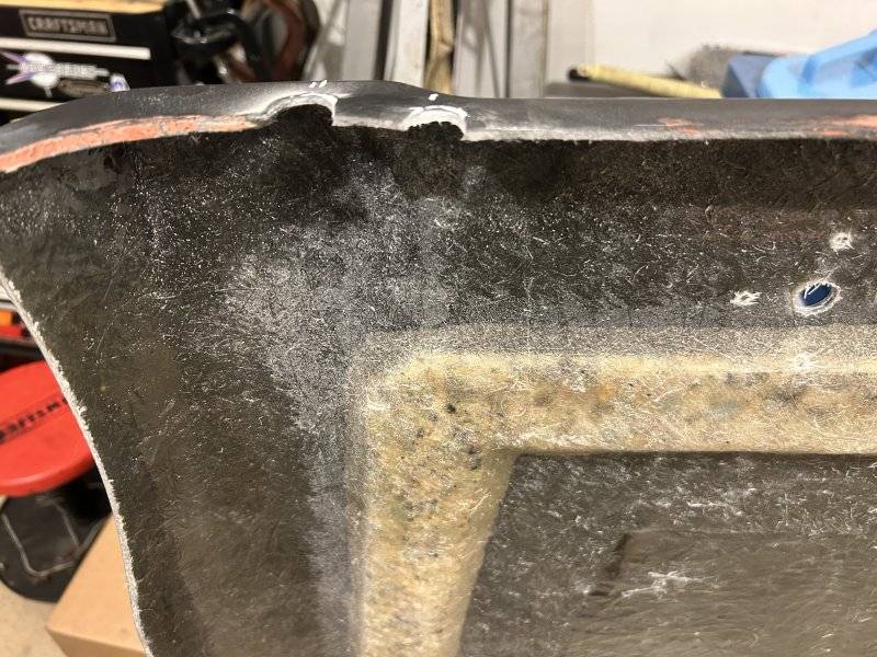

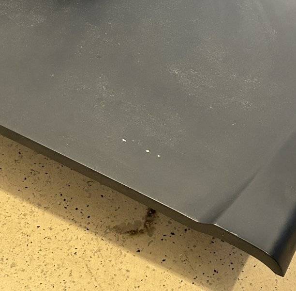

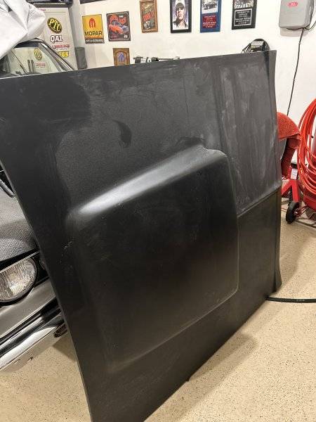

I had Glasstek reinforce the front and it really came out nice. They had a floor model at the Indy swap meet that I could have purchased, but it felt too wimpy. This one is way better.
I have a very similarly constructed hood from AAR, and it sank in the middle. I recommend taking a few minutes and glassing a brace running fender to fender, right in front of the scoop. I think that would help prevent problems down the road.
