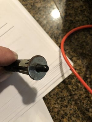

anyone here ever disassembled a non working glove box light and repaired it? I’ve tried 3 junkyard lights so far and none of them work. So any tips on fixing one?

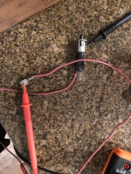

If you have an ohm-meter, hit it at thepoints shown in the picture, with known-good bulb installed.
If like this, you get no continuity/open circuit, the switch is either bad or contacts that hit the bulb are too dirty/loose to work.
If it tests good but still doesn’t work, then make sure you are getting 12v from the fuse box, and that the hole in the glovebox where the socket fits isn’t rusted, dirty, or loose.

Without a bulb in place you can check continuity at switch itself between outer chassis as shown and spring inside ( which makes contact with bottom end of the bulb )
