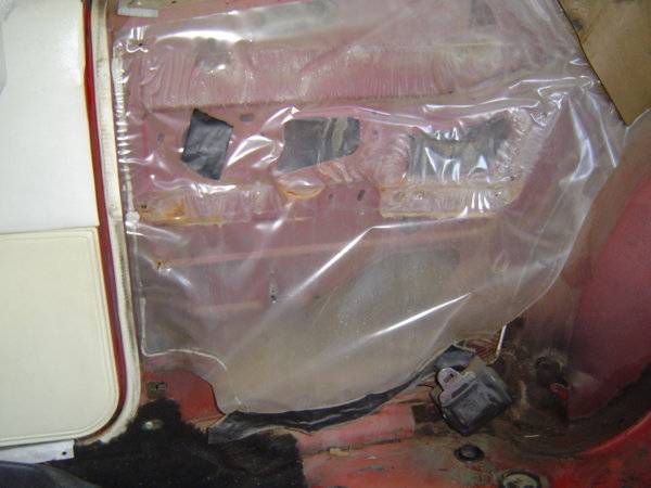

Originally they used 3m strip caulk white with some tape in specific areas. I used 3m black strip caulk just fine with my new plastic barriers.
Here is what my rear barriers looked like.
