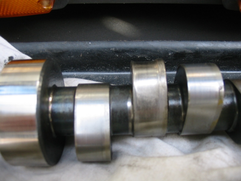

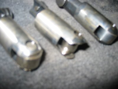

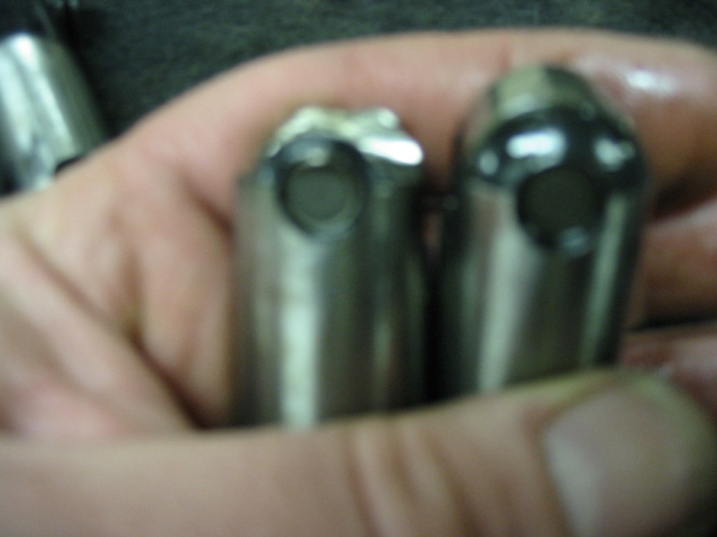

Kev,I had a few 829's go bad with slightly less spring pressure than you run.Time to step up the the better lifters:glasses9:
Ouch! That looks painful.
How many runs were on them?
I know we need to step up. We were going to but the last set up 829's lasted through 2 rebuilds, they had three seasons on them between the last rebuild and being replaced last year. I couldn't complain about that so we elected to go with em again.
So this got better.
We found 2 more broken Comp inner valve springs for a total of 3 and 4 valve seals that came off which the one was chewed up and found more pieces of viton and metal in the pan.
Sent the Comp rollers back to get rebuilt and they said that 3 of the 16 were total shot and couldn’t be rebuilt.... there were 55 passes on these lifters and valve springs for that matter.
