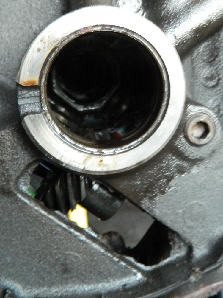

This whole I see below the cam hole area and can see a gear in other side, this pic is behind the timing cover, I hope it belongs there or else block might be garbage, crap.Thanks

hard to tell from pic but it looks like the intermediate shaft. Runs off cam to turn oil pump below and distributor up top. big block right?
yes this is that 400 I tore done to do stroker, but I don't know if that hole should be there or not, the edge looks chipped up so figured it broke open.
No, it's not broken. That's called casting flash. It's left over from the casting process. A lotta folks clean all that up and deburr the whole block. I never bother unless a piece looks like it's gonna break off.
You're askin good questions. That's the way to learn.
why would the edge of the HOLE be jagged like it was broken, and what is a cost to get block all done, dipped, check if it is cracked what ever that is called and .030 over and square and finish the deck new cam bearings, frost plugs , I got a price here to have it all done ready for stroke kit.thx
**** I was scared for a minute, now I can sleep tonight.
It's all good dude. You learned somethin new. Consider today a success.

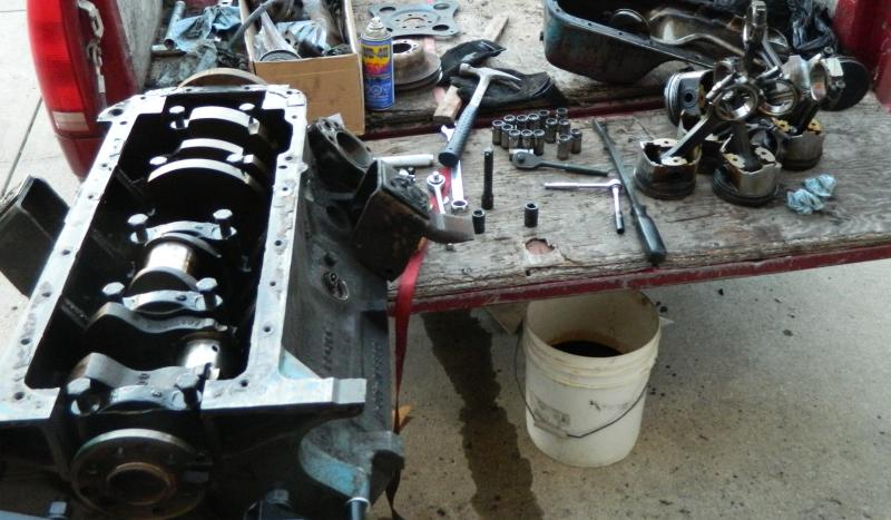

Yes today turned out to be a good one, and I am a person that likes to learn and never say I already know that, and even if I do. LOL Thanks for all the help and will get couple more prices around, this guy I was referred to would charge me 850.00 with parts. That is twice the price of you guys. WOW
