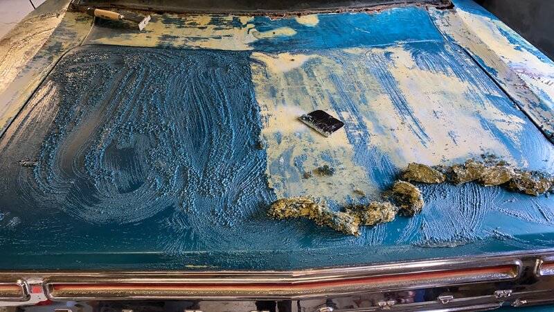

In Europe i cannot find Aircraft paint stripper, so I'm using Rustoleum paint stripper, it seems to be working fine, the GTX has 2 layers of paint on it, and the first seems to be getting of quickly.
Any other experience with this product?

I have not tried Rust-oleum, but your photo shows the results I usually get with "aircraft stripper". It usually can take 2 coats to get down to the factory primer/metal.
FYI, aircraft stripper can be VERY nasty to work with. You might actually have a better product...

Rust-Oleum smells like gasoline on steroids, it does not burn right in you hands.
I take the second coat right now, i can see the bare metal.

Looks like it's doing better than the last Aircraft I used. Yes I could tell a difference from when I had used it last. Definitely not the same.
I cover stripper with plastic to keep it from evaporating, and walk away
I have 15Liter of Rust-Oleum, two coats are enough to go through 2 paints layers and 1,5 primer layers, almost at bare metal.
