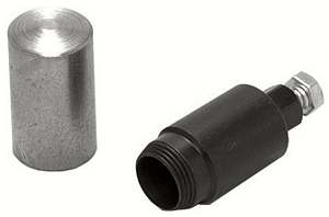

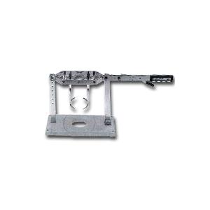

Lookin for a good overhaul transmission kit for a 1967 big block torqueflite 727, transmission was in decent shape and came from a driving 440 car, but leaks around the shifter linkage seal, so im gonna be opening it up and would like to go ahead and replace everything. Looking for mostly street use, with occasional track days. I need a full overhaul kit, not just a new filter and gasket. Thanks for the input!! Also, anybody know of a 727 transmission rebuid walkthrough video? and are there any special tools?
I recommend "Torqueflite A-727 Transmission Handbook" by Carl Munroe. Good explanations and pictures, and only about $15 on amazon. The book lists special tools you might need. Not all are necessary, but sure make the job easier.
you will need a clutch spring compressor to disassemble the front drum, snap ring pliers,
a "c" type valve spring compressor will work to help remove the kick down servo
a 15/16 impact socket will work to drive in the new selector seal.
most likely your leak is from the kickdown lever post on very top there is an e clip remove it the washer and you will find a small cup seal. all most always overlooked during a rebuild.
you will also need bushing driverrs
