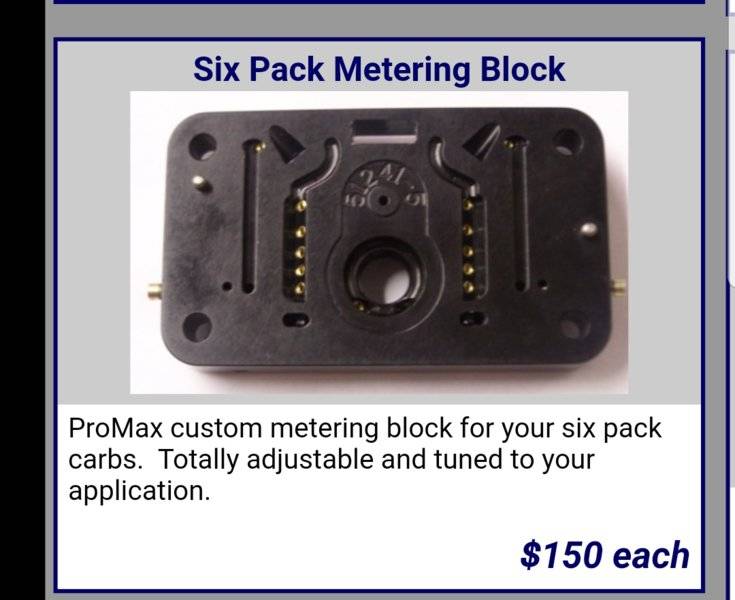

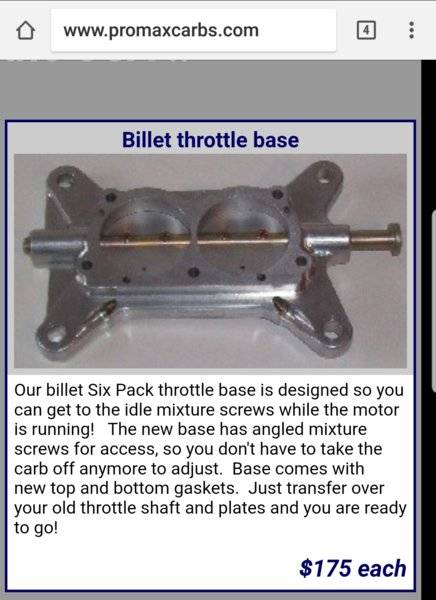

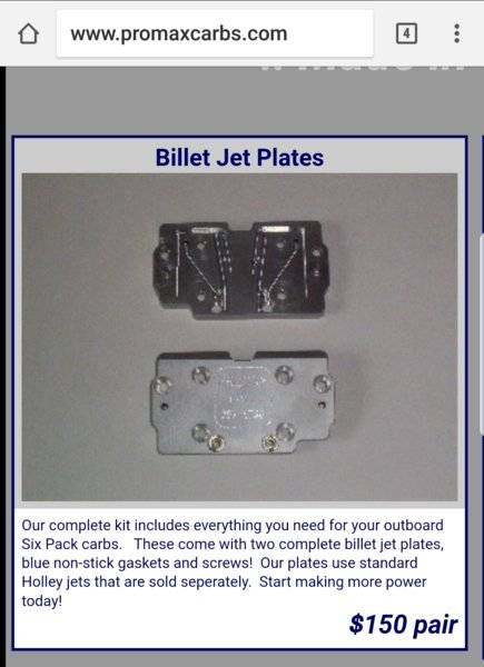

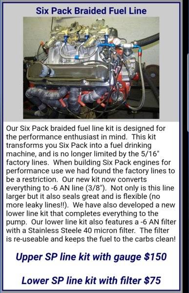

Bought the Carter M6903 high flow fuel pump for my 6bbl 2 years ago at a big Mopar show and race, but I'm finally ready to install it!
So I bought a new "stock" vapor separator/filter unit since I don't know how old the one I have is, and I am sending my 3x2bbl carbs to Promax when my Promax parts are ready! They will install all of my new Promax parts, "dyno tune" (as best as possible) my jets, power valve, etc, and send them back with an assortment of jets.
and when they come back to me, I'm using this to hook them all up!
Thanks guys.
I have a set of TrickFlow 240s on my "list" and :lowdown:IQ52 was kind enough to spec out the parts I needed for a particular purpose with them, and I WANTED to get them (and I will) BUT traction has been a problem, I have cut 1/2 a second off my 1/4 mile time by adding 17" wheels for 315/35/17 drag radials, ignition system with a rev limiter so I started power shifting, and since then I installed my Passon Performance a855 and switched out the 3.54s to a 4.10 R&P. With the adjustable pinion snubber, 3 way adjustable CEE-2730 rear drag shocks, QA1 or Viking double adjustable 2 dial front shocks, driveshaft safety loop, line lock all in hand or on their way, I believe I made some smart investments that will improve my times and safety, and provide a better foundation for the TF 240s.
These Promax parts are all part of "buying smart" building towards bigger and faster performance, and can be used for my future stroker motor too!

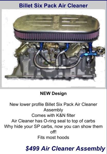

Did you get this air cleaner?
No interest in that at all! I am building out a N96 setup and that would defeat the purpose. Only have the hood and scoop installed, fiberglass air box is at the ready. The rest of the parts I salvaged aren't worth fooling with since new parts are available.
