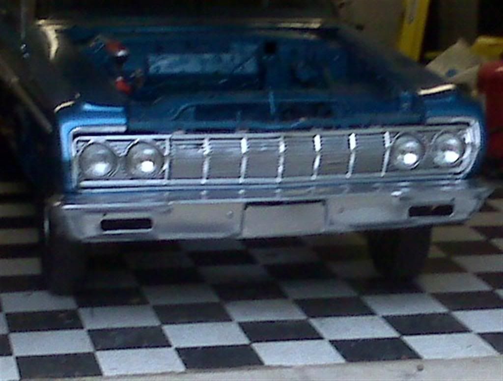

I have a fiberglass bumper and got tired of $300 quotes to paint it... So I did... For $6..LOL... I have to wet sand and byff it tomorrow to fix a few runs then clear it.. but not bad..... Sorry the photo was taken with a camera phone..
Looks good. I'm interested in hearing what you did for paint and prep also.
I am no body guy but what I did was sanded and primed it. Then wet sanded with 1000 grit, cleaned it off and tac cloth it.. Spray bombed it with the rustoleum chrome... I have to fix a couple runs on it then I am going to clear it... Better pic coming..

Killer chrome will run about 275 to do a bumper plus labor as I was told you have to buy the extra can of chrome and th eclear.. For me this will do for a while as this car is my weekend warrior.. And mainly at night..

I talekd with one of those chrome companies, and they told me that it looks like highly polished aluminum not chrome. I did my back bumper the front is next.
The pic is very bluffy but from what I can see it looks good. Ron
