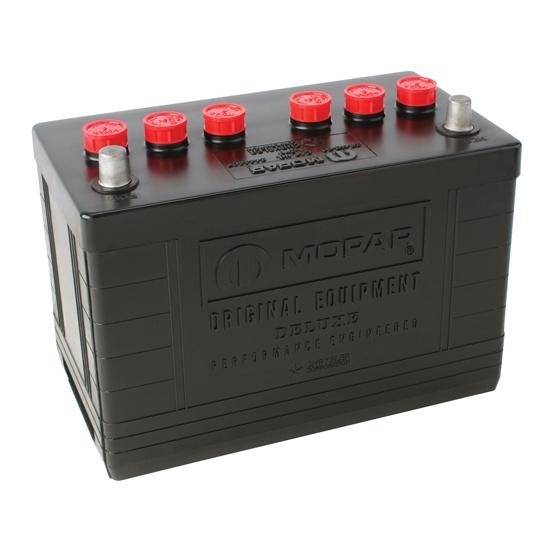

Gut the old one. I have done two like this one now. I am on my third year on this one in my red Charger now.
If you buy a new one and want to just sell the old case, I'm interested.
First I took all of the caps off & drained it upside down for probably a couple of weeks in one of my drain pans before I had a chance to get to it. Then I used a cut of wheel & cut the bottom open & with an air saw, side cutters & pliers slowly worked out all of the plastic molded dividers, lead plates, absorbent mat, etc from inside little pieces at a time. This takes time and patients not to break the outer case while breaking the inner guts apart as it is all injected molded together from the factory. I probably had 1-1/2 to 2 hours into the whole process & in the car.
Thanks I am going to give it a try. My battery does not have the removable caps. So I assume a can drill a couple holes in the bottom for draining and then get to work. What gauge cable did you use to attach the Odyssey Battery?
Oh yeah, the newer ones are sealed now & do not have the removable caps. I now have one of these newer sealed batteries that are now junk also. I just used two 12" long standard size battery battery cable to connect the two.

How did you connect the Odyssey batter to your old mooar restoration battery terminals???? I haven't taken mine apart yet, so I can't tell what im getting into? Thanks
There’s a couple pictures in this thread showing the connections. I have a couple dead restoration batteries stashed away I want to try to gut but haven’t got ambitious enough yet…

Well I've got 4 Mopars and have bought a battery for each , plus one for my good friend in Tennessee, from Battery Central Mall. A guy in Virginia . His name is Wayne, hes a nice guy... Fair price BUT I recently had one go bad after 1.5 yrs and he wanted me to send it back to the Mfg who has pitiful reviews online and is slow as sh**. Doesn't respond! Wayne offered no help to me whatsoever. I had to incur shipping costs both ways and "hope" that this "manufacturer", who I don't know.... would help me! Screw it and Wayne. It looks like they are "formally" doing what you did...i can see a white battery inside of the Mopar restoration battery case???Im going to try your way with the 2 bad ones I have.
