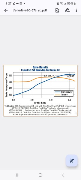

It's been done
Tuning the 6 pk will be the key to drivability. Well thought out build, bet your wife loves it. She may even let you drive!
I believe that's a .600 lift camshaft. Not exactly a mild grind. Probably not a bad driver but large either way. Goes to show the amazing potential in these TF240's for sure
It's actually a very reasonable camshaft, made by Howard's. Something like a 240/247 ( similar @50 to what I have in my street 383 hft). Don't let the .600 scare you. You have to open the valve to let the horses out.
I built a replica for a friend and it's as friendly as TF designed it to be
