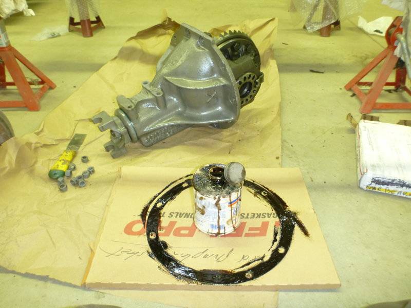

Old school, paper gasket and Aviation gasket sealer and never worry about it again.
