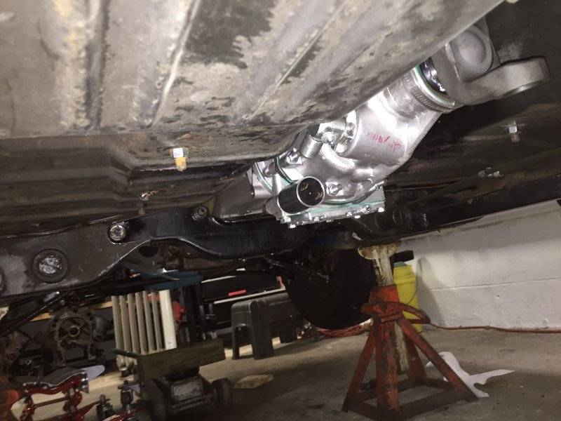

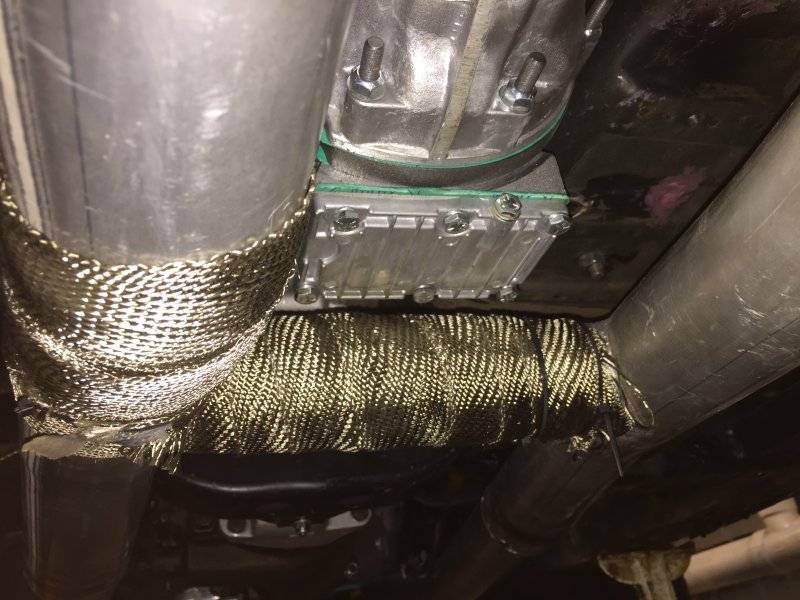

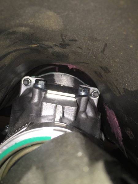

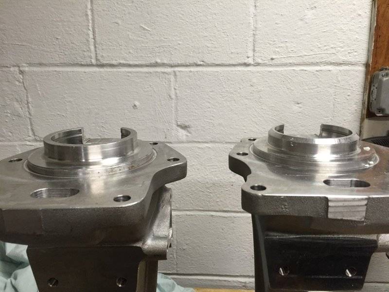

I put one in my 67 when I converted to 4 speed in 2016. Excellent support from them during the installation and after the sale. It was fairly straightforward, I did have to bang out the floor where the top 2 bolts go. I did have to cut and flip the 3" tti H pipe because it interfered with the unit despite being told opposite. Other issue I had, apparently mine was first, was the tailshaft they supply is straight where it goes behid the gear, mine was beveled because the gear was beveled and it wouldn't fit. I sent them my tailshaft housing and they based the new design off that one. The only other issues I had was I had to shim the rear nose up a little to account for the longer length of the entire transmission now, and the control unit went south, there was an issue with the older models that was resolved in the updated ones. Because the H-pipe is so close to the unit, I wrapped the pipes in header wrap, and then found out it wasn't necessary (pictures show tie straps just for mockup). I'd do it again if I had a 4 spd in the car already, if I was converting, I'd get a 5/6 spd and use that. (Keisler was in their death throes when I started collecting parts, that's why I went that route).
