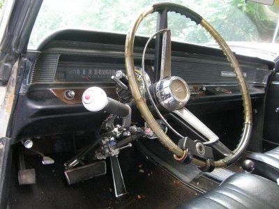

i use hand controls now, due to a spinal cord injury. i have a 64 pontiac catalina 2+2, my hand controls have a b&m shift knob with a momentary contact button (for roll control or nitrous) hooked up to the horn. that way, i don't have to let go of the handle to honk.
if you're able to keep your balance, using hand controls will allow you to drive as aggressively as you need to. drag racing's a piece of cake, autocross or road course tracks might be more of a challenge, but certainly doable.
(man, i need to vacuum my car)
That looks like the setup I bought. Can you take a few more pics of the steering column mount and the pedals please so I can see how yours is set up? .

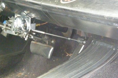

very hard to see in this, but there's a clamp that goes around the column which supports and aligns the whole setup.
there are 2 stainless rods with clevis ends that attach to the brake arm (NOT THE PEDAL) and the throttle arm. the further up the arm, the shorter the travel on the hand control.
the clevis ends attach to two very simple brackets that sandwich the brake arm and throttle arm. make sure they're tight, you don't want those to slip!
it may be best to have a professional shop do it, because despite the cost, it's a pretty important mod.
