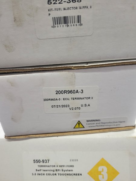

Here's what we have so far.. I got roped into putting a P1SC kit ( used) onto a fairly modified car.. so I decided to ditch the factory ecu and go with holley. Getting a 3 bar sensor, TFI harness, the holley conversion IAC, fuel pressure sensor, ECT,I hope the injectors are larger than 30 lbph. Procharger? Where's the pulley? Looks like an easy 500 rwhp sitting there.
What do you have for fuel system on it?Here's what we have so far.. I got roped into putting a P1SC kit ( used) onto a fairly modified car.. so I decided to ditch the factory ecu and go with holley. Getting a 3 bar sensor, TFI harness, the holley conversion IAC, fuel pressure sensor, ECT,
Having to learn more about these than I ever cared to. 3.7 pulley, had to get a new one after going to the $2000 renegade bracket...
One thing I haven't addressed, what do you do for the fuel pressure reg? View attachment 1766263

Stock with an unknown pump upgrade. 36lb holley injectors.What do you have for fuel system on it?
That will support about 375 rwhp boosted, maybe less. Not nearly enough injector for that combo. Stock fuel system with a 255lph high pressure pump will support around 500 rwhp boosted, but you'll need a mini.um of 42 lb injectors and I would stay away from Holley units. Jmho. Stock regulator is fine and is boost referenced.Stock with an unknown pump upgrade. 36lb holley injectors.

All of that stuff probably has the compression figured to run on premium pump gas, maybe on the edge of it depending on what it is. Adding boost might create issues....It's got edelbrock heads /fancy cam/ headers and a trickflow intake as well. Really didn't want to light the world on fire with boost, I think the bottom end is original. I guess I'll leave those final decisions on the dyno guys. They're mustang guys

You account for that by removing timing in the spark table. 11.5 target af in boost. Any richer causes problems like lifting ringlands.All of that stuff probably has the compression figured to run on premium pump gas, maybe on the edge of it depending on what it is. Adding boost might create issues....
What is that anyway? Old 5.0, new 5.0, 4.6?

I forgot to respond to your question about fuel pressure regulators. I used the mr gasket one on my 66 as it comes with regulator, fittings, and a gauge. I can get the part number. You'll need adapters for the stock rails or aftermarket rails and lines.Here's what we have so far.. I got roped into putting a P1SC kit ( used) onto a fairly modified car.. so I decided to ditch the factory ecu and go with holley. Getting a 3 bar sensor, TFI harness, the holley conversion IAC, fuel pressure sensor, ECT,
