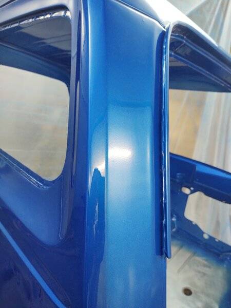

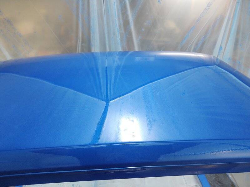

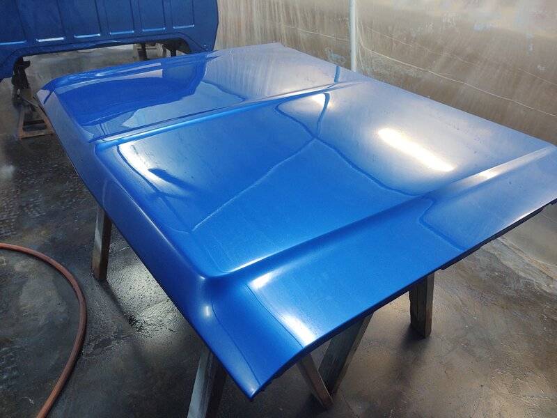

Went back to the trusted and true method of hanging plastic for a paint booth with great results. Thought I'd share this for others who do their own painting without a booth.
I picked up a cheapo 12'X 20' carport from Harbor Freight, the tent frame makes for an excellent, quick and easy booth... just duck tape 2 12'X50' plastic sheets to it and your done.
Dad's truck is moving right along.

View attachment 1004942 View attachment 1004943 View attachment 1004944 Dad's truck is moving right along.

be very cautious of static. Ive seen these make shift booths go up in smoke. Ground your car with a booster cable to the floor. Just be safe.

I'm just picking around,but
Do I spy a gravity indicator?
I ask because they are my specialty. I tell my wife "that's how I know I have put down just enough".

Just call me "Eagle eye"
I'm only good at spotting them because they are my arch nemesis. And I'm just picking with you. The job you have done is amazing. Love the color.
Up by the seam on the cab. A little run. Not a big deal. An easy fix.
LMAO, never heard a run called that.. Yes sir, the next day when I pulled it out into the light and gave it a good going over I spotted 3 of them, 1 absolutely identical to that in the exact same spot on the opposite side and 1 along the edge of the rear window.
It's funny when people like my dad come over and spot them like it's a horrible thing (granted nobody wants runs) and don't understand the big picture. I told him I could give a rats *** less about a couple runs, the clear is flat... Sand and buff 3 runs vs sand and buff the whole cab to fix orange peel.. I'll take the runs.
