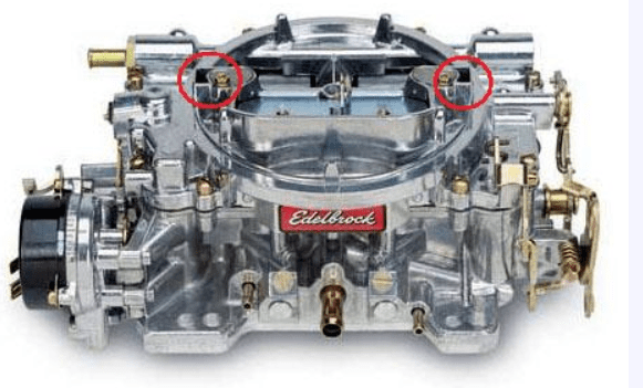

After setting, hold the choke plate open and pump the throttle. Is it squirting gas?
Easy enough to test. Use a squirt bottle and put some fuel into the vents. If it starts right up the bowl was empty. A auxilary electric pump will cure the empty bowls on start up.

When the car sits for days, do you FIRST check the carb to see if it squirts fuel when you actuate the throttle by hand ? ( Before you do anything else ? ) It's not fuel "boiling" it's the fuel EVAPORATING. You changed the carb for no reason.

This simple test is what convinced me of the root cause (fuel is evaporating from the carb).
