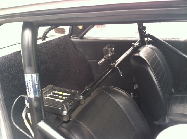

I like the bolt through the bar with the sleeve in it. RCI Platinum for $79.00 for 4 year certification.
If you can wait another month, I'll have a set for sale brand new with good dates for $67.00 and with 4 year recertification.
Thanks anyway but I've got a long way to go before my car is ready so I'll wait till the last things before ordering a harness. That way I won't waste any of the 4 years. Sorry, I have to ask, Is that harness tab right behind your neck? Seems like if the seat gave backward any your spine would get chopped. Just curious..
The seat is now fixed to the roll bar, so that wont occur. My 65 Plymouth is done the same way now.
