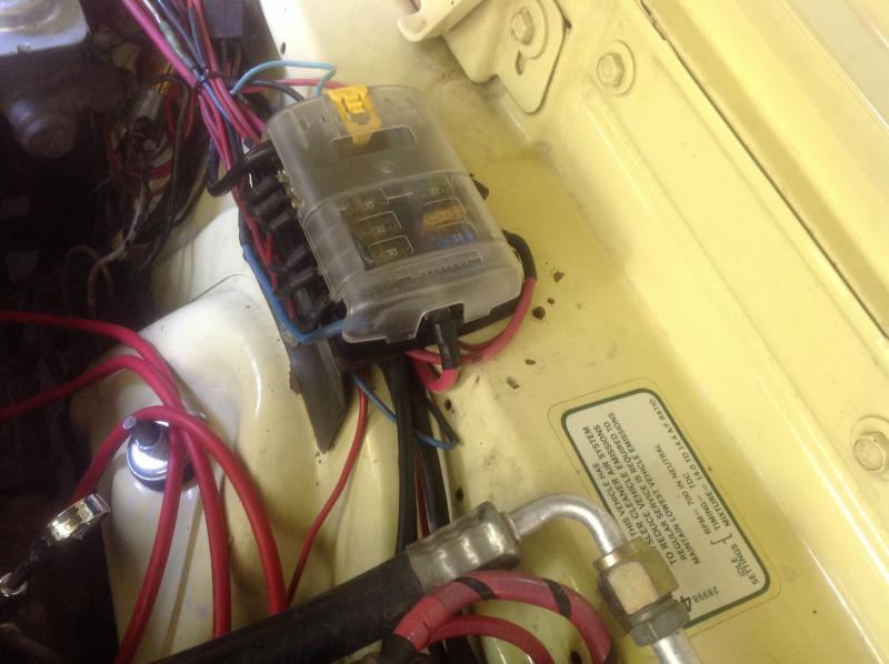

This is stop-gap to support the QTP's, power windows, ac, Valentine 1, Garmin, and dash cams. Car needs complete rewire. The box pictured comes from West Marine, high quality stuff and works well for now. Make sure the hood hinge does not crush the box when closing if you mount in this area. Ask me how I know. image.jpg
