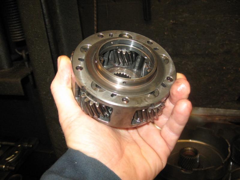

Like most things, they are easy to rebuild if you know what your doing and have the correct tools. The cost of the replacement parts for a stock rebuild is pretty cheap, under $100 (without converter), what you paying for is labor, and maybe a warranty.
Most hot street cars (usually less than 500 HP), will get the HP clutches and Kolene steels, maybe better bands, and a shift kit, maybe $200-$250 in hard parts, and about an extra hour labor to do the shift kit.

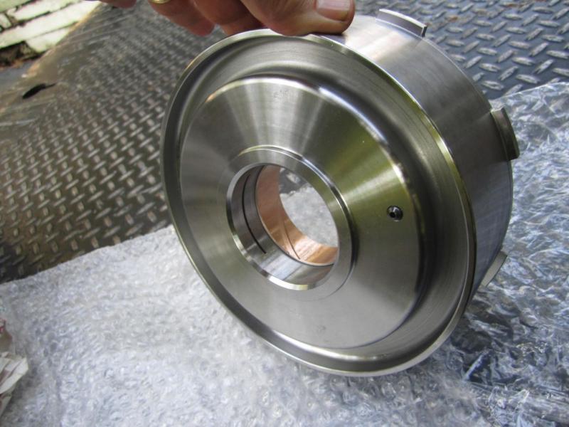

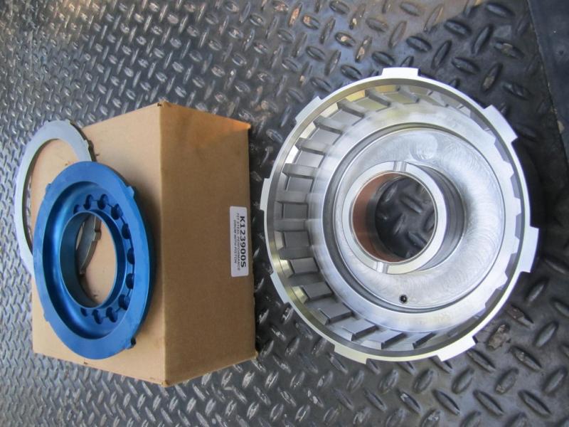

A true high performance rebuild can get expensive really quick. The aluminum splines on the front gear of my 727 were cracked and ready to strip on the last rebuild, and the nice 4-pinion billet gear with thrust bearing was $500. The Billet steel drum was another $500+. The Ultimate rear sprag was $200. The Billet aluminum rear drum, lightened sun shell, max lug race pump, manual valve body, billet servos, and such really add up. Not to mention the cost of a custom torque converter ($1,000+.)

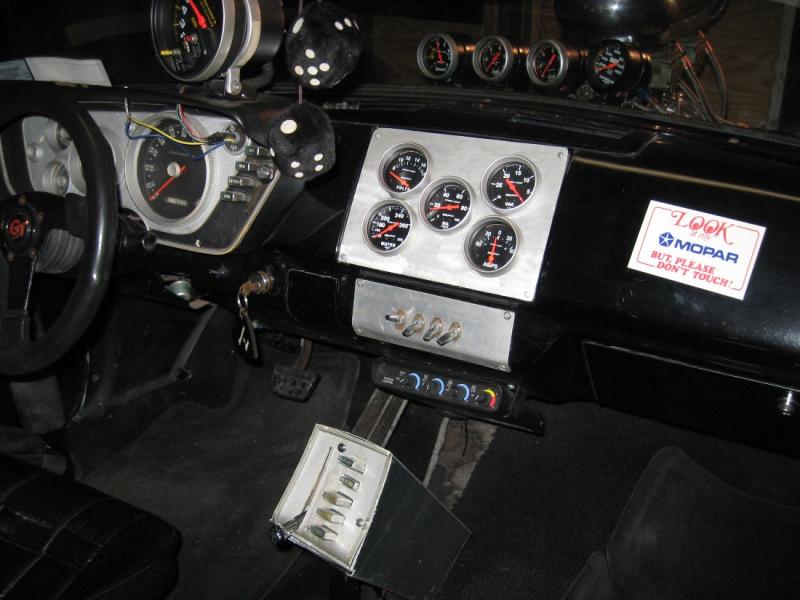

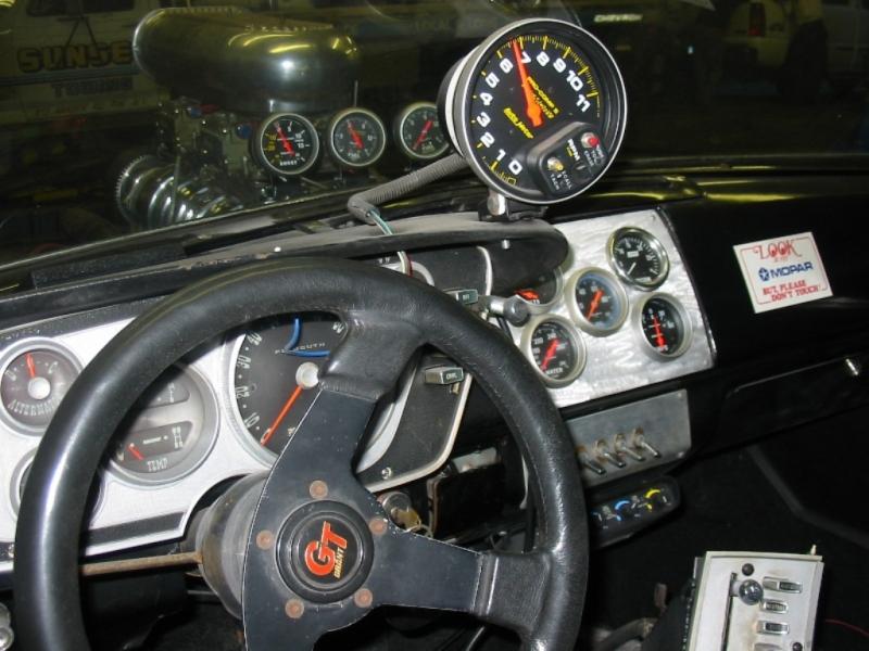

That's why I said "plus goodies"
Everytime I hurt or blow something up,I do my do homework and upgrade to avoid those painfull ka-blewies.
So again to the OP,the goodies needed depend on what HP your at and what you plan on doing with it.My junk is 90% street driven and taken to the track for MOPAR & Nostalgia stuff.By NO means am I any kinda trans expert,just another addicted go fast guy with many ka-booms:grin:
