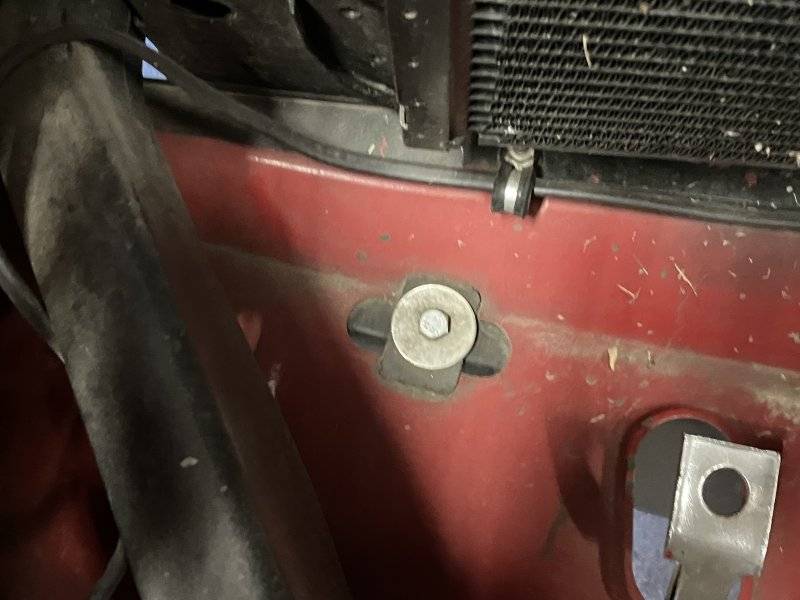

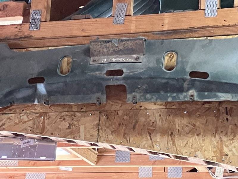

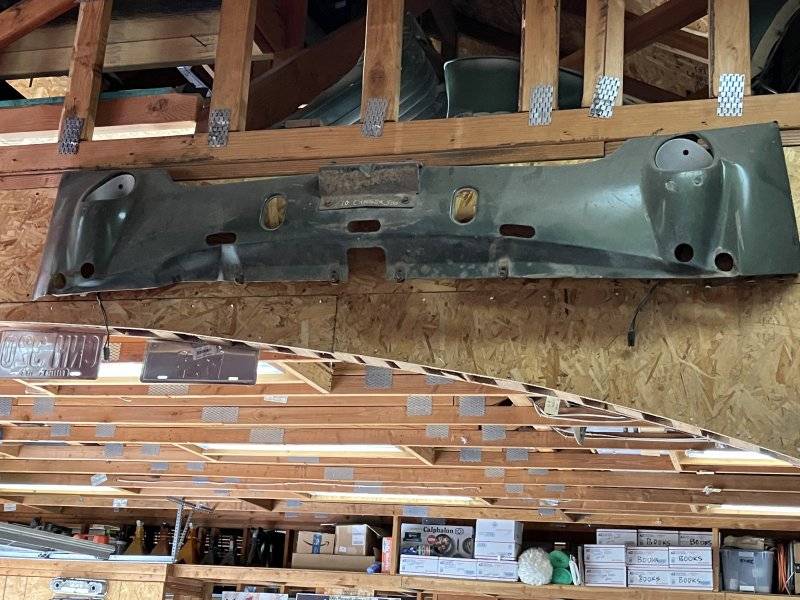

I repurposed three holes already punched in the valance panel. The1970 has oval holes as a seen in this spare:
I made sheet metal washers and used those existing oval holes.

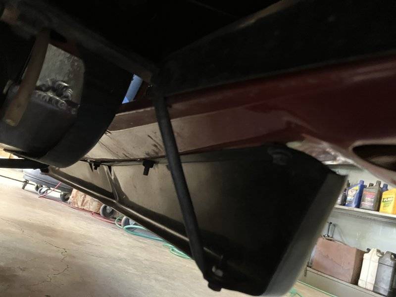

I did put a screw in the outer corners.
You can see the small brace I have on the ends.
This was all low tech.

Today I’d make a different brace at the end but these simple ones are still in place. I think they are 3/8” fuel line. I don’t remember.

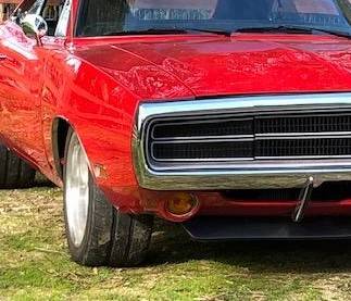

Thanks for sharing your installation pics, Kern Dog. I bought one of these for my Charger. It's still in body & paint and I'm having mine painted body color (Jet Green Metallic). I couldn't care less what make of car it's intended for; I just like that it looks and fits good, hides the torsion bar, may improve aerodynamics by flowing less air beneath the front end and causing lift, and improve cooling by forcing some air up into the radiator...and it's very inexpensive, to boot! To NOT install it would certainly favor the purists, but for all the logical reasons, it seems like a no-brainer to install it. :)
I like a bit of a rake to the car so maybe there is some aero advantage?
I'm not sure. I did it for appearances.....
