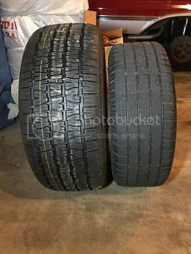

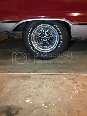

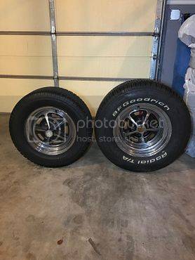

Well I was able to get 275/60-15 BFGoodrich T/A's on 15x8 with 4.5" backspace to fit under my '67 Satellite.
Compared to the 235/60-14's that were on there:

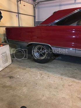

Video of both sides:
Be careful at first, those are awfully close on the outside.....
That does sit pretty high in the back though.
I have air shocks on the back and it could stand to come down a bit. I have a little more pressure on there to pick it up when the 14's were on there and didn't adjust after the test fit.
The wheels are an old set my Dad bought for his '68 Charger. I was mainly trying to see if I could get away with off the shelf backspace (4.5") or if I'd have to go the customs route. Ideally 4 3/4 would probably be the sweet spot but it at least I know how much room I have to work with now.

I didn't need to do anything to the springs, but I had to get the car pretty high due to the tire height and tucking it under the lip. I guess what I'm gonna have to do is throw my alumimun jack in the truck and have with with me in case of a flat. Small price to pay to get the wheel/tire size I want.
Very close indeed. While this setup "fits", I was more test fitting to see how much pace I had in the back to get a custom set of wheels built. After seeing what I have to work with, I'll probably order a set of 15x8 with 5" of backspace. If things to get too tight in back I'll a tiny spacer to move it out.
I also dropped the PSI in the air shocks to lower it a little...looks much better now.
