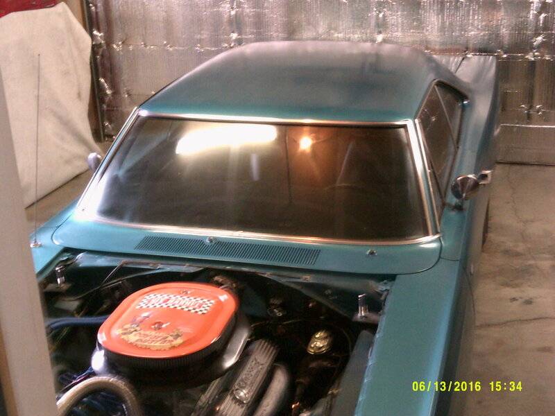

I painted it Ultra Flat Black 12 or so years before too
that was easy, compared to a metallic surf turquoise metallic base clearcoat
lots of work & lots of mess

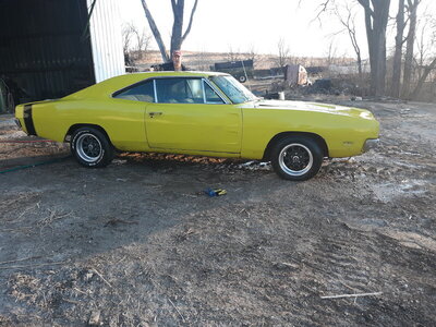

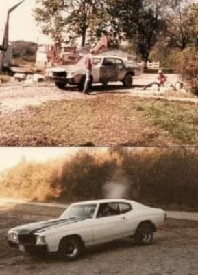

This was the first one we did from 1986! LOL,
Charger still rocking the paint job from 1988

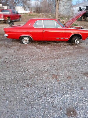

65 dart in '92, and the 72 satellite we first painted in '89, it's paint job didnt last as long and we are in the middle of sanding and a repaint. Last one I painted was my parents Ferd expedition, and I have lost count how many gallons I have sprayed. 3833D26E-CEC5-4CC3-A436-2C327370557D (2).jpeg 20200109_162932.jpg 20200325_195031.jpg 20200724_094941.jpg

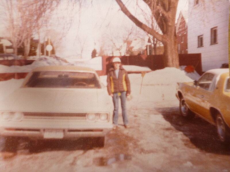

1977 (I was 15), after doing the rotted lower quarters on our '69 Fury II so that my sister could drive us to school. Wagner electric spray gun and lots of thinner. It actually came out really nice, only one run at the bottom of the passenger door I missed in a badly lite garage. Last one I plan on painting.. I'm with RC on that!
That Fury on the left seems to be listing...
Nice Fury on the right!
LOL, one wheel in the mud, the other up on ice. Dad's new '76 Fury Sport on the right..
