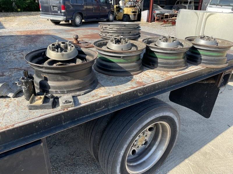

Have you seen these green stripes on the inside of your wheels? These are the original Rallye wheels to my 73 that were removed in the 80’s for a set of cragar SST’s. I’m guessing there is a reason why they have this stripe or band on them. Any ideas??
I cannot say that I have ever seen that stripe but my guess would be is that its is to allow quick and easy identification during production.
Seen this many times, appears that:
14x5.5 rallies have blue stripes
14x6 rallies have green stripes
Small bolt rallies have yellow stripes
15's are no stripe

Makes for easy ID during production on the line then. :thumbsup:
