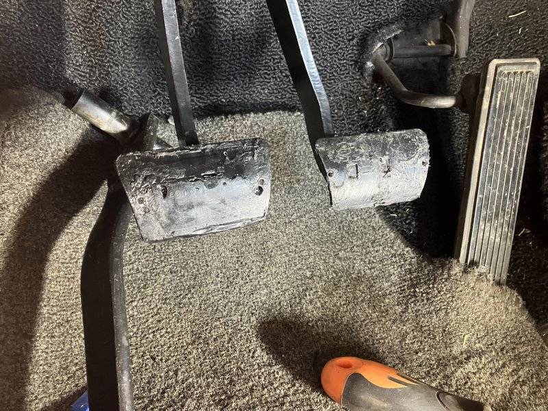

You can see remnants of an adhesive that I tried awhile back. Yeah, it barely helped.

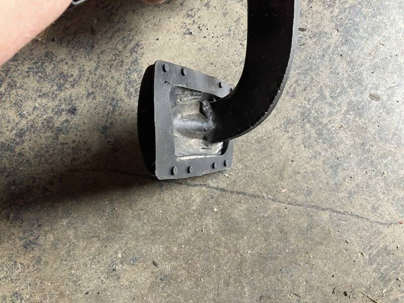

The height of the metal pad in the original A/T pedal was just shy of 1 and 3/4”. The SST pedals…
Just a hair over 1 and 15/16”. Here is a view of the fit from the back side….
I don’t know if in a perfect world this would fit and stay but it wasn’t working for me. What to do?
I was careful… I had a moving blanket to catch sparks and such.
I cut both metal pads down by approximately 1/8” and drilled 4 holes in the face of them so this stuff…
…could seep through a bit to better anchor the pads.
I’ve had good luck with that adhesive with weatherstrips.
Hopefully this will hold together. I have a road trip next week of approximately 850-900 miles so that ought to be a good test.
I think the combination of the curve of the pads along with them being slightly too big was the problem. If you’ve had this problem, cutting the metal pads may help you.

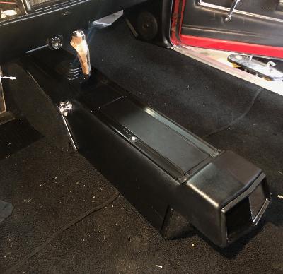

I actually like the look. I painted the console lid matte black in 2021 to tone down the chrome flash in the interior.
