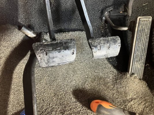

Ever since I did a 5 speed Tremec swap in my car in 2021, I’ve dealt with poor fitment of the pads and yes, they have slipped off a few times too.

Through the years I have seem many people have a hard time keeping the pads on. This is on new cars and trucks from the factory. I also have seen many that never had an issue. The problem ones I cleaned up and used 3M weatherstrip adhesive to set them in place. Contact cement works just as good.

The car is a Dodge, not a boy racer Subaru WRX. I peeled off the pads.
You can see remnants of an adhesive that I tried awhile back. Yeah, it barely helped.

Part of it could be the shape of the metal….
The pad does not have to curve as much to fit the metal. Now look at the dramatic bend of the Silver Sport pedals.
About the only way a pad can come off is by being pulled up and off. The side of a boot or shoe against the side will pull it up and off. Driving with work boots seem to be the main cause. Lots of other cars besides mopars get them pulled off. Clean everything well, coat the surfaces, stick them together, pull them apart and let the glue flash and stick them back on.

The height of the metal pad in the original A/T pedal was just shy of 1 and 3/4”. The SST pedals…
Just a hair over 1 and 15/16”. Here is a view of the fit from the back side….
I don’t know if in a perfect world this would fit and stay but it wasn’t working for me. What to do?
I was careful… I had a moving blanket to catch sparks and such.
I cut both metal pads down by approximately 1/8” and drilled 4 holes in the face of them so this stuff…
…could seep through a bit to better anchor the pads.
I’ve had good luck with that adhesive with weatherstrips.
Hopefully this will hold together. I have a road trip next week of approximately 850-900 miles so that ought to be a good test.
I think the combination of the curve of the pads along with them being slightly too big was the problem. If you’ve had this problem, cutting the metal pads may help you.
