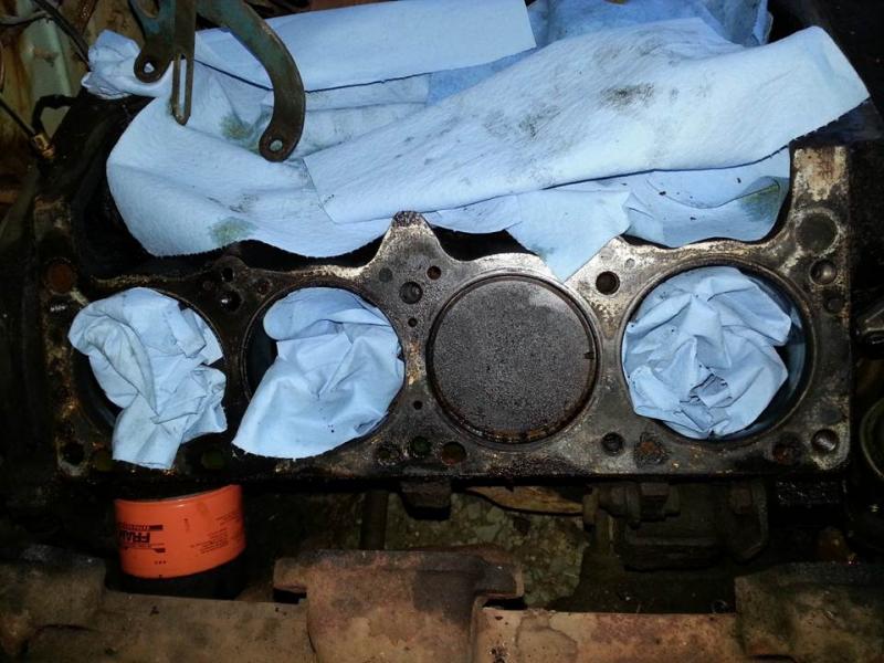

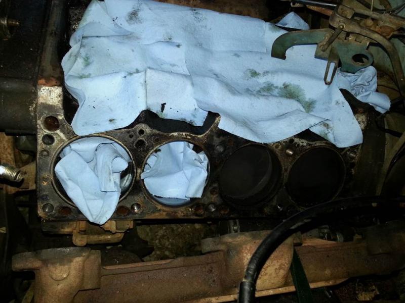

Another question, what's the best/easiest/fastest way to clean Head Gasket Areas? Seen a lot of different ways elsewhere but wanted some opinions from here.
if you are not doing any work on the short block do this:
scrape off any big stuff with gasket scraper.be careful not to catch any edges with the scraper.
then wrap bar stock or a real good hand body sanding tool with 800 grit sand paper.sand in an x pattern,not strait up and down or side to side.will not only take off any small stuff,but will check block for any warping as well.make sure you tape off the valley before you sand and vacuum out the cylinders with a strong shop vac when done.
Does the gasket scraper need to be plastic or one with a razor blade on the end?
Is the Hand Body Sand Tool like you use for paint removal?
Also, which tape is best to use?
Fine wire brush for an electric drill and parts cleaner. Just make sure you have everything sealed well, shop vac the residue and wipe clean with a lint free towel. Brass brush if you can find one. You want to leave the surface smooth and there is no need to remove any metal leave that to a reliable machine shop.
I just use a single edged razor blade and carefully scrape everythig clean; sanding can produce fine grit that will get into the cylinders.
Either way, once you are done, use ATF and fresh paper towels and wipe and wipe the cylinders over and over to clean; you will have to turn the crank to bottom the pistons and do each cylinder 3-4 times; the pistons moving up and down will tend to push any crap to the top of the cylinder bores where you can wipe it off. once you get a good clean wipe, you are good. Then use alcohol to wipe the head surfaces squeaky clean before you install the heads and gaskets.
Head warpage needs to be checked by a shop and the heads need to be surfaced with a special grinder if any warpage is found; you can't do it without the right grinder. Google 'cylinder head grinder'.
K thank again
After wiping the ATF thru the cylinders, do I need to make sure the cylinders are dry before putting the Heads on?
No, you should leave a skim coat of ATF on the cylinder walls. Or wipe them down with a thin coat of clean motor oil. A small amount (well less than a teaspoon) of ATF or oil left in a cylinder will do no harm.
