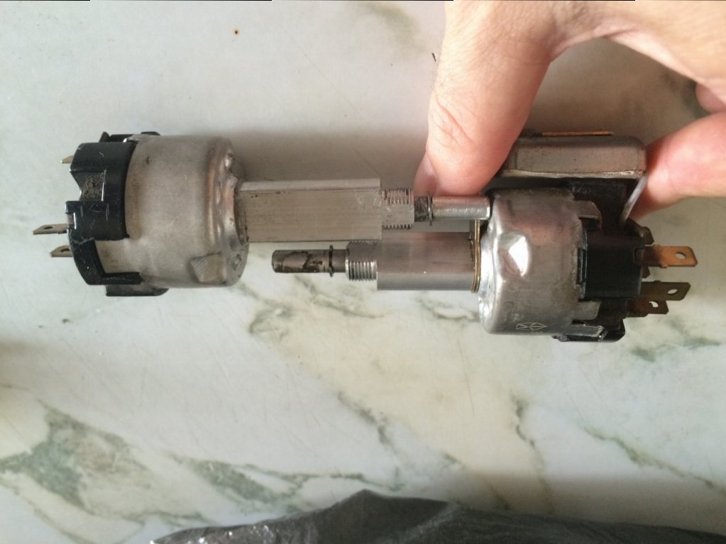

a standard rallye switch can be cut to the lenght of a Rallye switch. I did it once with a 2 speeds standard rallye switch to fit on my recently upgraded rallye cluster set up, while I worked on get the variable/3 speeds wiper system upgrade.
Just disasemblied the switch housing, removed shaft and shaft column from switch round housing. Cut, some press to fit back and some epoxy glue to reinforce the job amd VOILÁ!
I still have the switch around and can post pics.

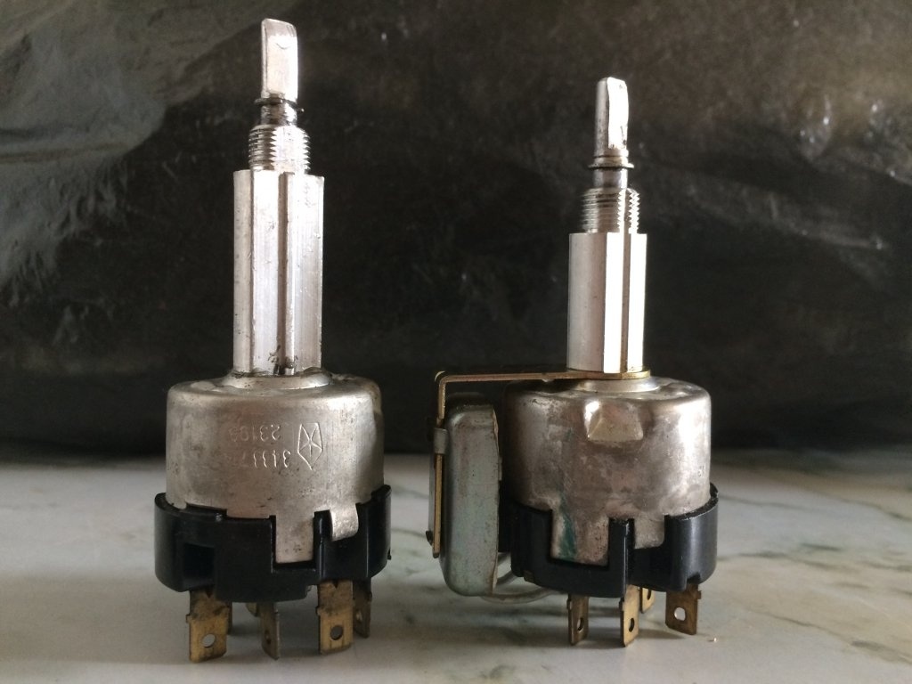

Ok here is a 72/74 Standard wiper switch I modified to fit on to a Rallye Cluster side to side to an untouched 72/74 3 speeds switch. I used the 71 variable switch which came with the Rallye cluter I bought to measure the shaft and column and cut to the size. I used this modified switch for a while I still had the 2 speed wiper setup on my car. Worked FLAWLESSLY!
Later, got a 3 speeds switch ( the one on the pic ), but at the end decided to use the 71 variable switch on my 74 once I completed the 3 speeds motor and linkage setup. I found also the switch plugs for it on a 71 harness I found laying around and kept the 3 speed switch as a spare ( have the plug for it saved too )
After get the 3 speeds switch, noticed the one I cut was a bit longer. Thats maybe because the 71 wiper baquelite is more thin than the 72/74 so theymade the 72/74 shaft shorter due the thicker baquelite body for the prongs.
HOWEVER, the switch I modified fit perfect on my dash with enough room on back

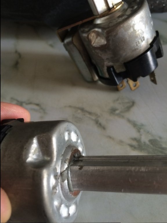

Here you can see a bit of the epoxy used just to reinforce the assembly, althought it assemblied really tight!

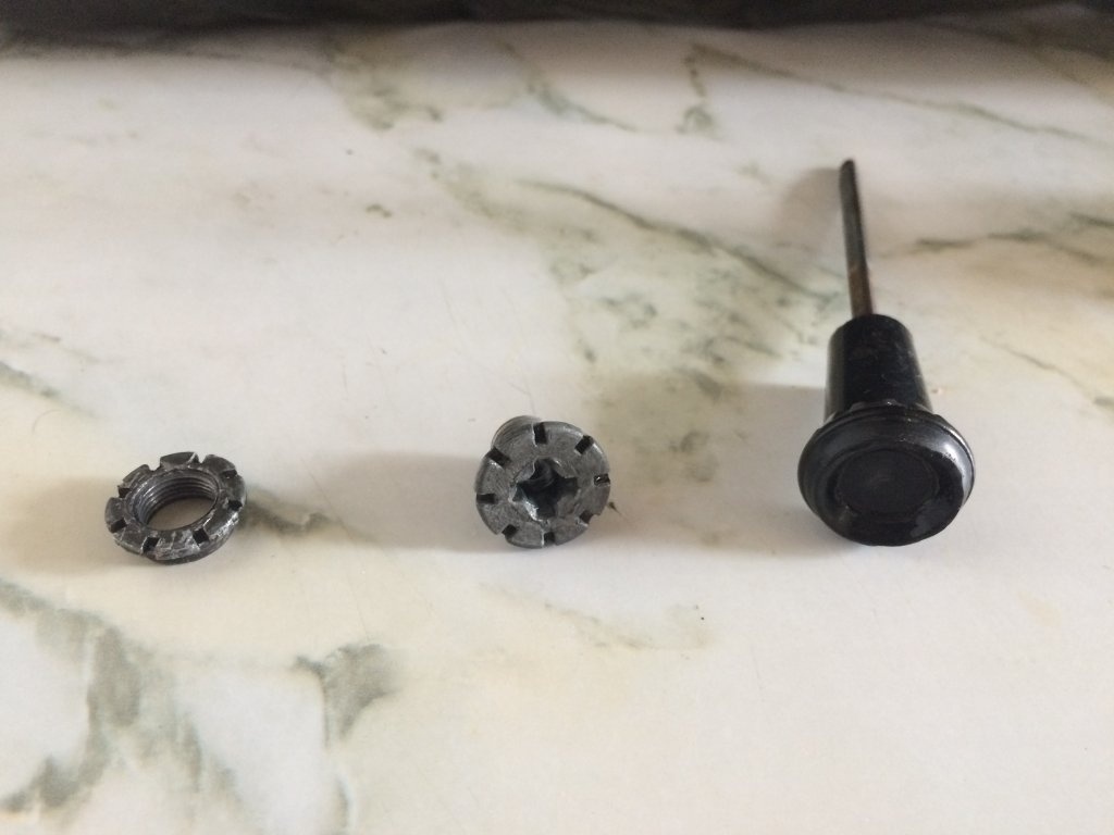

and here a nut set and headlight knob for Rallye cluster. Like magic I found a Rallye cluster locally with kilometers speedo ( searched for it by 8 years, since the Rallye cluster I bought back then was in the States, so was in Miles ) and this got the nuts and just this knob.
I COULD GET RID OFF THEM ( sell ) if you need them and can't find over there, but... I'm not as you know in the States.
Headlight switch needs to refinish the blue strip.
