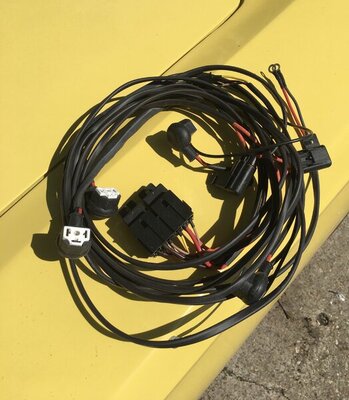

I finally got to install the new head light harness from crackedback here on this site and I must say it is outstanding! Very well made and works as advertised. I also had a brand new 60amp alternator from Tough Stuff I installed at the same time. I think I made a mistake with 60amp alternator, at idle charge is reduced and everything is under powered, above 1,000 rpm it great. Should I have gotten the 80 or even 100 amp??? The only after market draw I have is classic air air conditioning. I'm still using old style analog voltage regulator. 6D10153C-F86F-44C9-A65D-973B1AAD7DBD.jpeg

Nacho-RT74, thanks for the info, I should have done more homework. I read to many threads about burned up wire harnesses, but looking back that was from 120 amp alternators or bigger. I do drive this car a lot, in the rain, at night, A/C blasting and oh yeah, I have electric fuel pump! I'll update this post after I get new alternator installed
