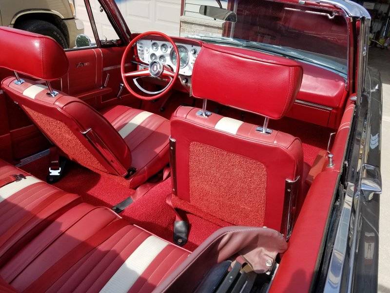

If you have 3 point belts why the need to lock the seats? To me headrests should be the most important at your point. Humble opinion.Agreed - the '66 Satellites have seats that just tip forward in a crash. Coupled with lap belts and no headrests (and a fixed steering column) they are pretty sketchy.

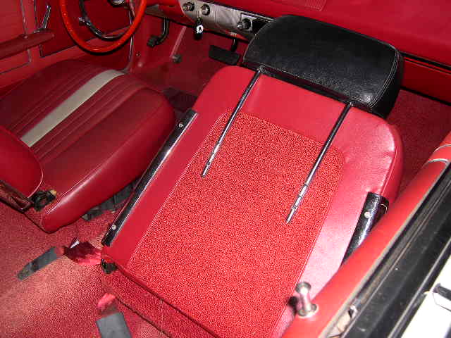

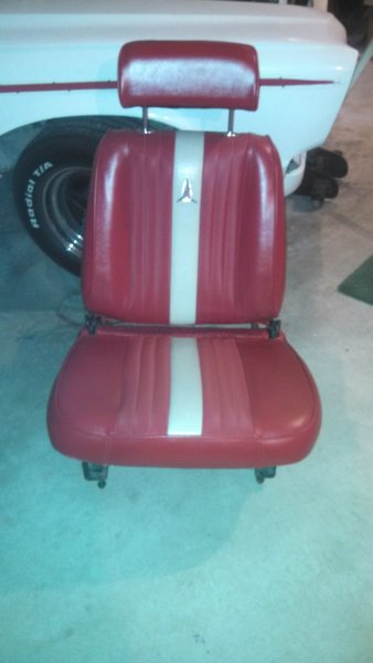

I've locked my front seat with some L brackets off the main seat back bolt so it can't come forward. I've also fitted 3 point seat belts and my above dodgy looking temporary headrests.
I've left the passenger seat unlocked for access to the rear. I'd love to come up with an operational locking device but I'm not that smart.
