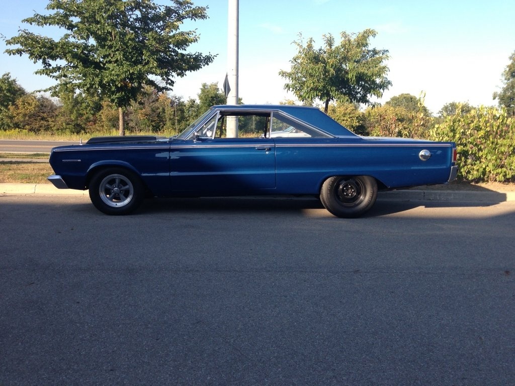

For reference the tires on the back of my old 67 were 255/70/15, it was a tall tire (29 inches) but it I loved the look.

When I bought my 67, it had 235-60-15 BF Goodrich radial TA on 8 inch wheels and the tires just barely rubbed on a standard backspace 15" Torq Thrust wheel. When I went to a 7 inch wheel Vintiques Magnum wheel the same tires clear fine. Have to jack the rear wheel about 3 inches off the ground on a floor jack on the frame to get the rears off.
