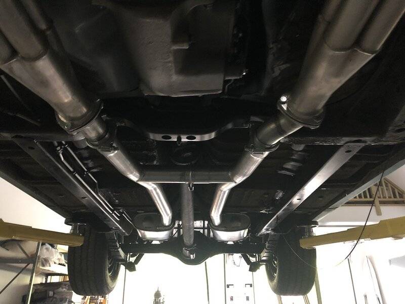

I just finished installing a TTi 2 1/2" H-pipe exhaust in my Coronet. Good stuff you really can't go wrong with it. Comes with Dynomax Ultraflow mufflers. I didn't spring for the tips. Was around $700-something.
How do you like the ultra flo sound?. I bought the magnum mufflers from accurate. Very quiet at first, almost to muffled. Couple thousand miles on them now really sound nice. Straight through with packing.
I was wrong, these are actually Dynomax Super Turbo mufflers, 17797 as mentioned above, my apologies. I think I'm just used to saying "Ultra Flo" when I say "Dynomax". The marketing creeps into your brain whether you want it to or not.
I got them from a friend who had the same exact TTi system in his Hemi Coronet but he switched the mufflers for a more factory-looking part.
Either way, my car is not running right now so it's not making any noise. Working on a bunch of other things but will report back when I can!
