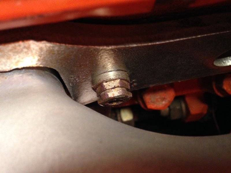

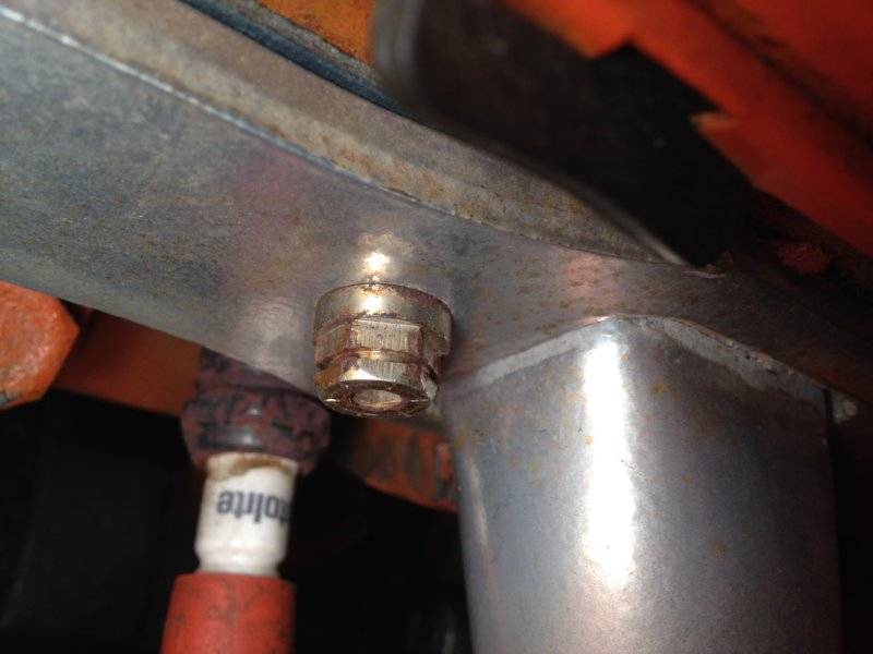

Admittedly, I'm a bit of a newbie with all this, but I'm surprised that my header bolts look like *this*.
Isn't the header usually just held on with "standard looking" nuts on studs from the head??
What exactly am I looking at here?
Does this look unusual??
Any helpful comments, *please*?

Google Stage 8 Fasteners. Someone got lazy and didn't put the retainers and e clips on.
Ahhh... Thanks very much!!
So I don't presently have any issues with the header bolts backing off. Are the Stage 8 Header Bolt kits a good idea (maybe I should order some)? Would using Loctite be an easier idea (cast iron heads)?
And I see that headers are held on with *bolts* into threads in the head (as opposed to *studs* in the head that nuts go onto)?
....so why did I read customer reviews on some header gaskets being too thick that the header *nuts* couldn't grab enough of the *stud* threads??)
