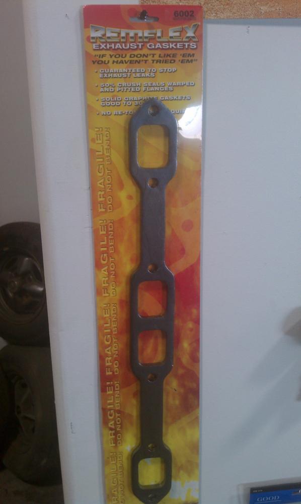

+1 for Remflex. Can't say personally since my engine isn't even in the car yet, but heard nothing but good reviews from friends that use them, and my buddy at Napa told me there had been a few guys that came in having a hell of a time getting their headers to seal, used the Remflex ones, problem solved.
They actually crush down to 1/2 their original thickness when you tighten them. Supposedly re-useable and like flyingfarley said they're "guaranteed to stop leaks." Mine are hanging on the wall waiting lol
"50% crush" I would have bought those if somebody around hear sold them, I know you can order them but I was hell bent on getting it fixed this weekend. I'm completely over all of these stupid issues, I just want to get back to making progress instead of all the backtracking especially seeing how most of my backtracking has been do to crappy parts. Looking at the Perceys I think they'll do the trick "I hope".
