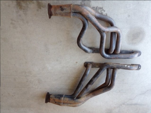

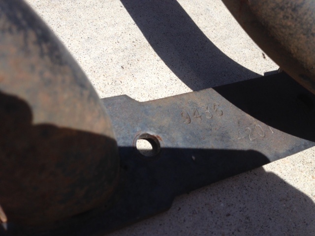

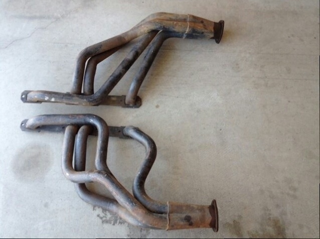

Picked these up at MATS yesterday, seller told me they came off a 1965 Belvedere 383. Mfg stamp reads Direct Connect with two arrows pointing at each other, the #9436 is clearly visible. I've searched online but not much info on them other than possibly made by Doug's or American Racing.....Any knowledge on these, who made them and will they fit my 383?

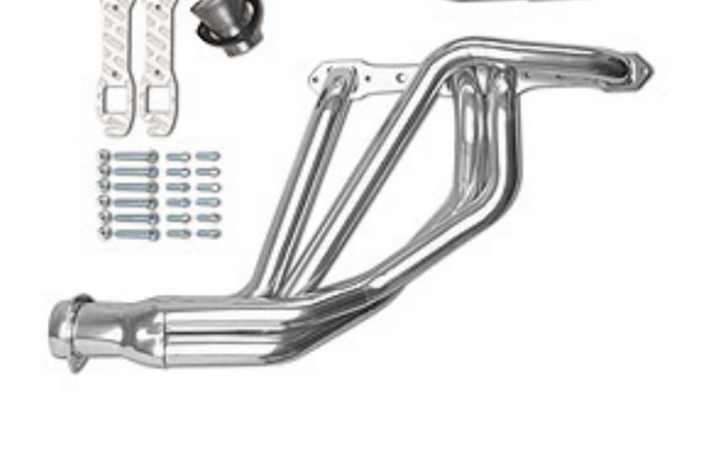

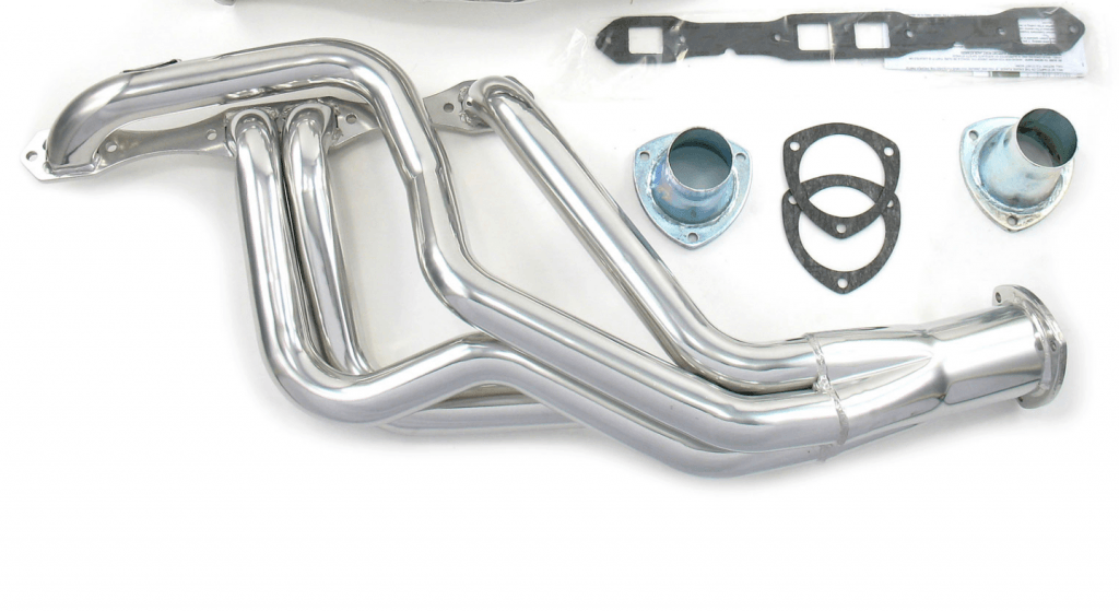

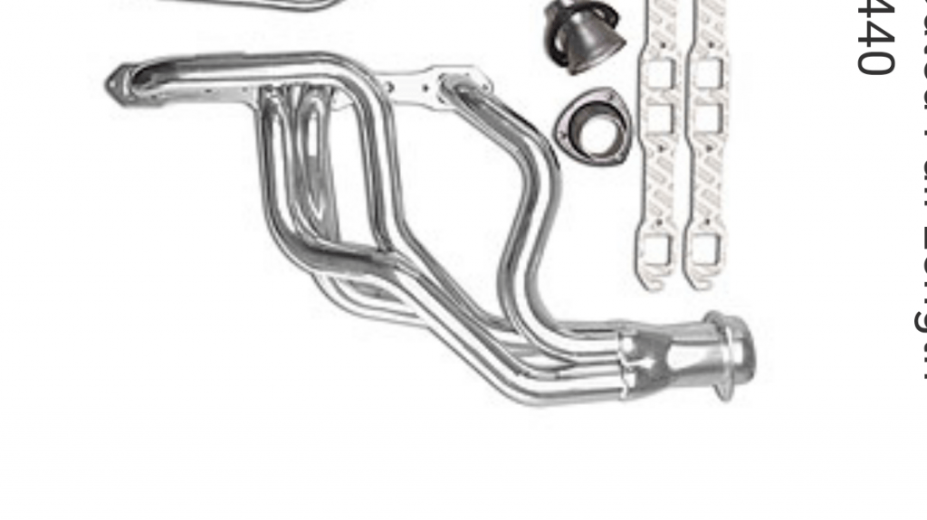

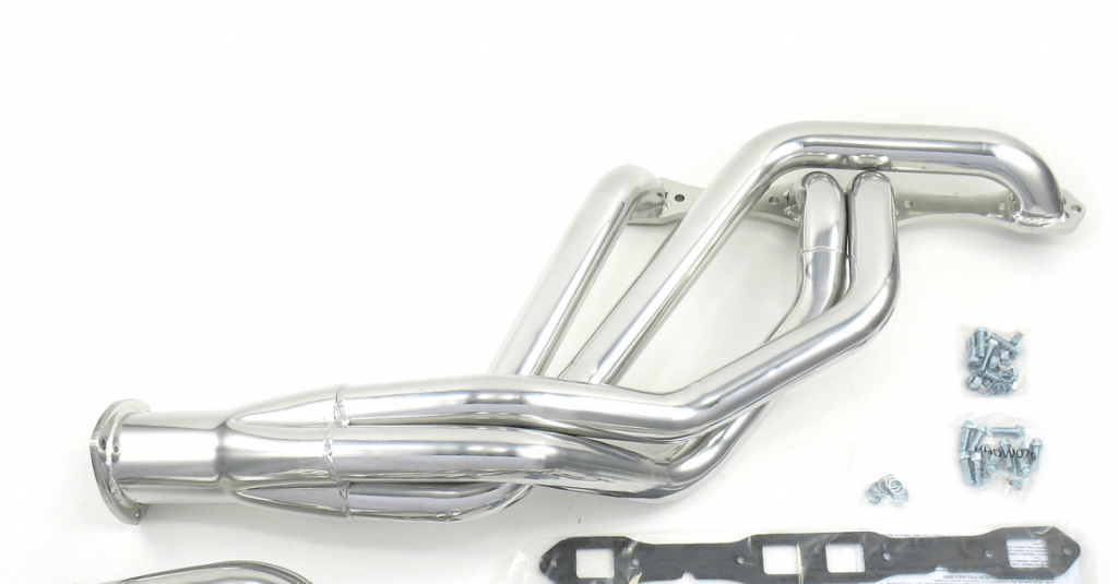

I flipped your pic to compare the driver side header.
This is the Headman header. Notice #1 tube position on the collector.
This is the Doug's header. #1 tube goes to the outside of the collector.
Thanks. Looks a lot like the Headman, can you do that with the pax side?
Thanks for posting this:thumbsup: Looks like they were made by Headman. I will probably have to beat them in :BangHead:
They will install fairly easy, from the bottom.
The problem I found with Headman was the starter clearance. I believe they were designed for the original, large starter and not so much for the mini starter. I know that doesn't make sense but it's what I've seen in my researching. Also from my own experience trying to use a mini on a set of old Headman's.
I have the stock starter....have to clean them up a bit and paint first. Thanks for your input.
