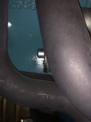

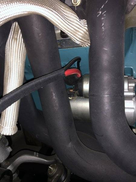

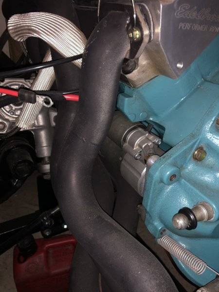

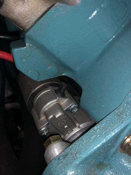

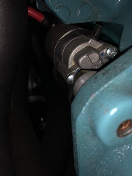

I have TTI 2” primary tube headers going on my 68 Road Runner. The car is apart for restoration, but I have the engine/trans, K-frame, and front suspension assembled on a stand ready to install. I do have Edelbrock heads, but I don’t think this will make a difference. A factory starter would “fit” but was basically touching a tube. A mini starter would not fit, no way, no how, as you stated. TTI said a robmac is the only starter that will fit. I patiently waited for a rebuilt one off their website. It does fit, and is indexable. I have not had this setup installed in the body yet, but no problems so far. I too have a 11” clutch setup. Should be same as yours.
