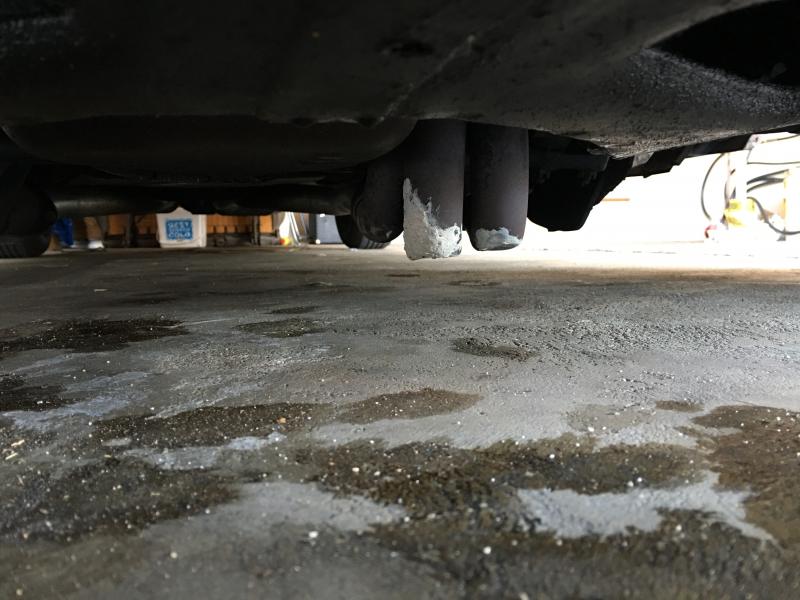

Thanks for all the suggestions, guys. I took a picture of the damaged headers and how low they are to the ground.
All the headers I saw online looked to droop about the same distance to the ground, but I could be wrong.
It's been suggested to me by someone with the same problem that I try a pair of shorty headers. I don't need anything fancy. It's just a 318 driver.
Looks like the ones I had on my duster. Like chinese food, THEM HANG LOW!
Yeah, they're pretty ridiculous. I just raised the front by an inch. Hopefully that will keep them out of harm's way until I change the headers.
