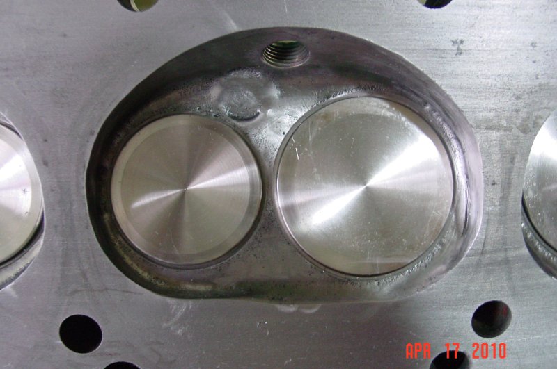

First thing is lose the pistons and build a quench motor, I did and its a beast. 915 heads ported/polished, light weight JE/SRP pistons, Mopar .528 Mech Cam, 6 pack setup, perfect .040 quench with .020. steel shim gasket. 520 HP on pump gas with dyno headers.

I calculated compression at 10.2, the chambers were cleaned up a bit and came in at 81cc. With normal lash .028 and .032 the cam doesnt bleed off much. Im running the lash tight at .018 and .022 which helps a bit
