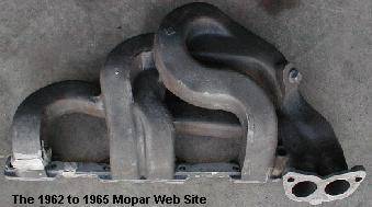

vs

So those "curly" ones are tri-y? I've only seen those in pictures, never on an actual car
Yes those are the tri-y. To the best of my knowledge, there is ONE set in use in a real tri y car. That car is valued at something like triple your "average" real maswedge car.
