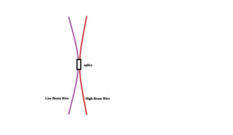

If I may have a slight hijack, How would one wire up the quads to have all 4 on in both low and high? Halogen, not HID. Always liked my quad headlights all on no matter whether hi or low beam...
I should just be to change the plug and splice in the high beam wire from the hi/low light? Nothing too tricky?
All four on anytime? Pretty easy. Like you mentioned, splice them. I would run a relay system either way being the high load with Halogens as well as all 4 on all the time:

I'm hopefully going to install my dash this weekend which means the wiring will commence, so it's time for me to figure out which wires I need to run. I like what you are doing and wanted to know a little more about the setup, how many amps do they require, where do you buy them, etc. My battery is in the trunk but the harness I used has a few extra fused circuits using 12 AWG wire and 20 amp fuses that I might be able to use to power the relays (headlights). If you've got yours working, are they bright enough that not having all 4 on would be plenty bright enough. Thanks
