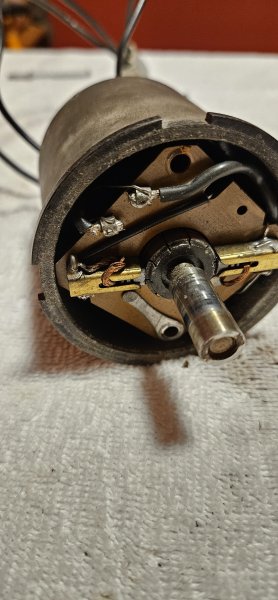

Hi, I would like to know if someone can help me with the way to solder all the wiring inside the motor.
My friend give me the disassemble motor, everything looks good inside and out side.

I try to find internal wiring for headlights motor but it looks like it's not in the schematic diagram.
I think I will remove one of my headlight motor and see what it looks like inside.

But before I ship my motor to Todd or Topher I will make a visual check, I have a good working motor it will be good a good reference.
I will connect the wiring the way it's supposed to be and see...
Thanks everyone for the help

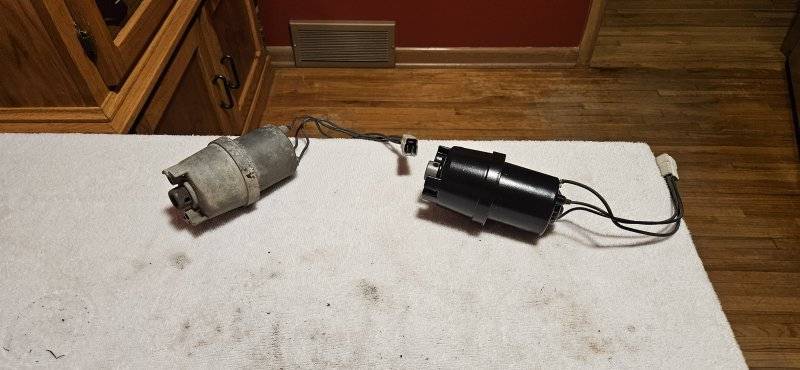

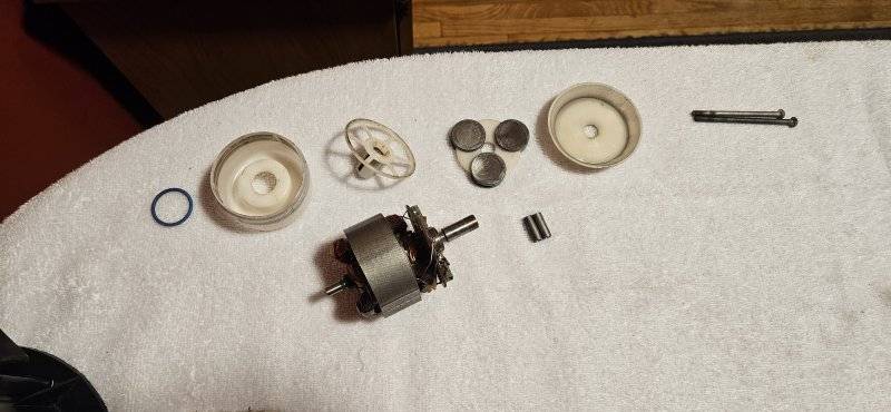

The headlight motor may seem very intimidating and they can be. This past weekend I decided to try my luck and dive into one. This motor did not work before I took it apart. I took everything apart and sandblasted the housing. I did not take the windings apart just cleaned them and the brushes up. Same with all the plastic gears just cleaned up and greased them. After reassembly the motor works perfectly fine in both directions. Picture shows before and after

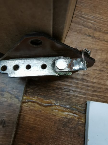

Is there a thermal interrupter in there?

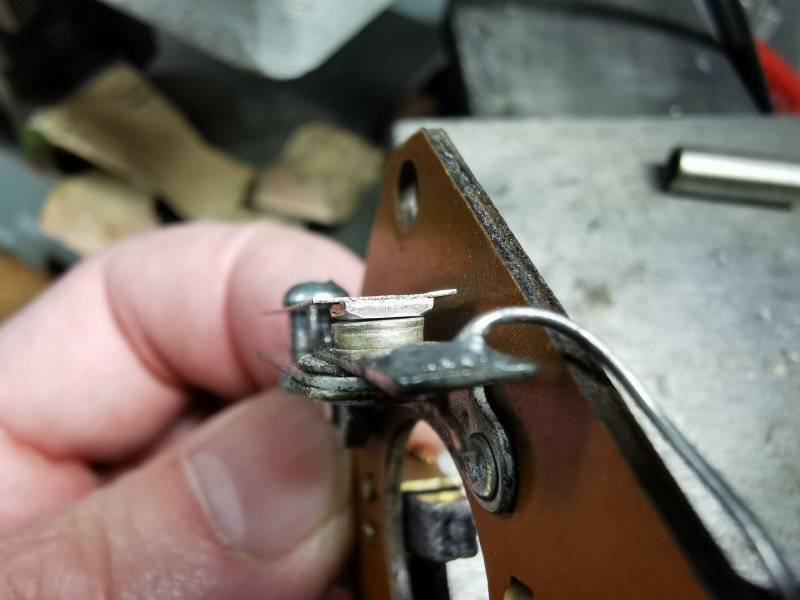

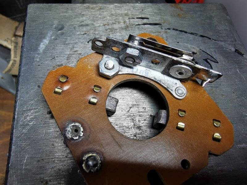

Can you make a close up picture of the the connections under the fiber plate.
I would like to see were wires are connected to the top fiber plate.
Thanks

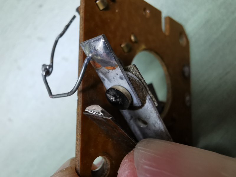

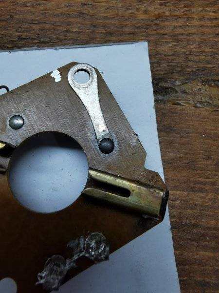

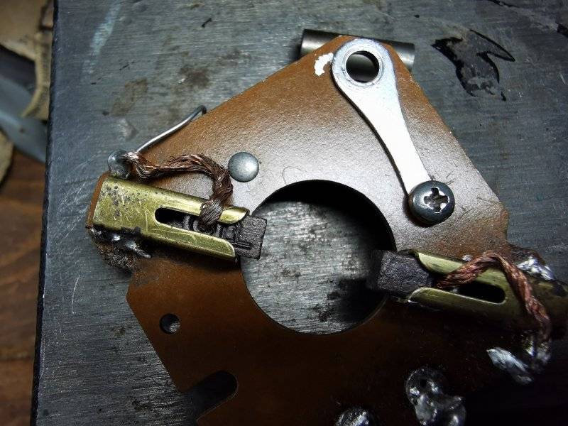

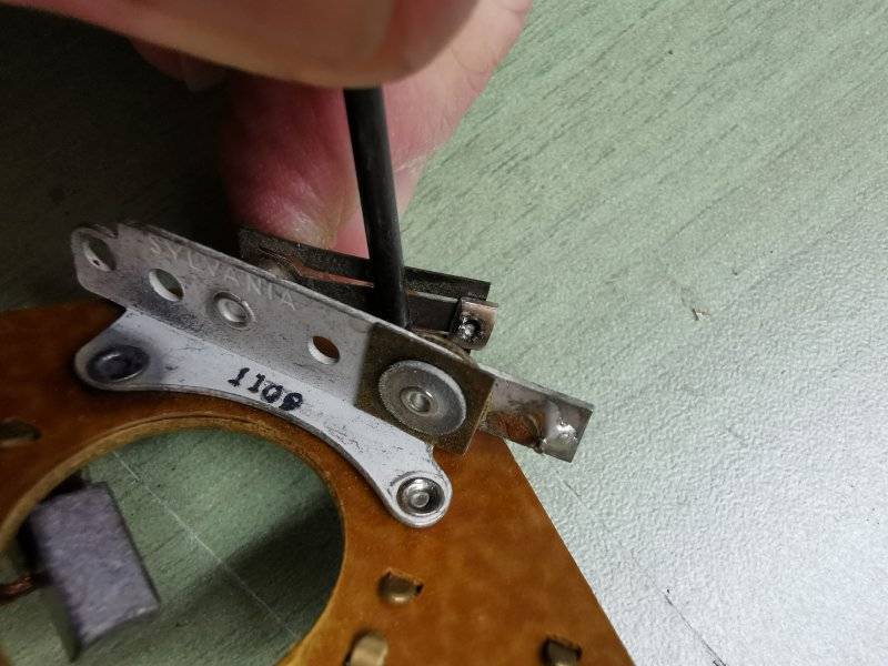

Tips to improve headlights motor when you rebuilt it.
Under the 2 brushes holder you have a thermal interrupter, the problem is after years the 2 rivets became loose and poor connection happens.
Those rivets overheat and make problems.
Rivets remove and new hardware installed.
